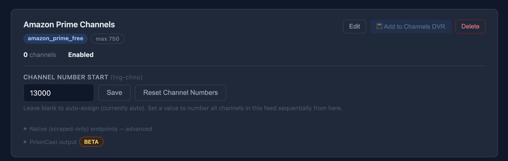

No channels stuck in Review... and I tested the PrismCast bridge interface which is now working properly... but when I add Amazon Prime Channels as a feed, it still returns 0 channels even though the source says I have 890 "ok"... not sure why I can't add them...

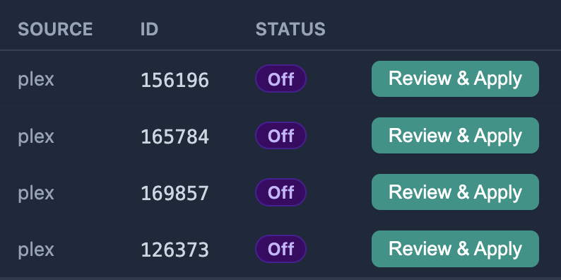

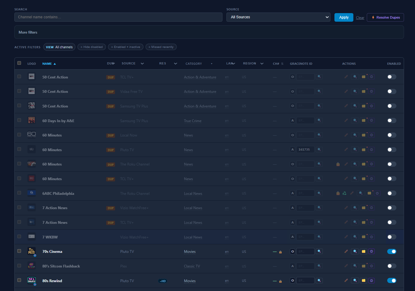

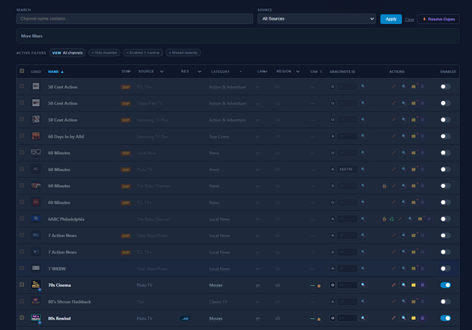

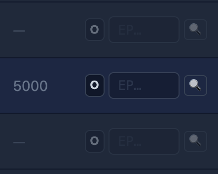

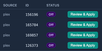

I wiped and re-installed FC over the weekend, disabled all sources except plex, and it automatically assigned gracenote channels perfectly. This morning I woke to find the gracenote channels were gone, and when I checked FC a majority of the channels were marked "O" (as in gracenote mode: off) and the IDs removed. Any idea what causes this?

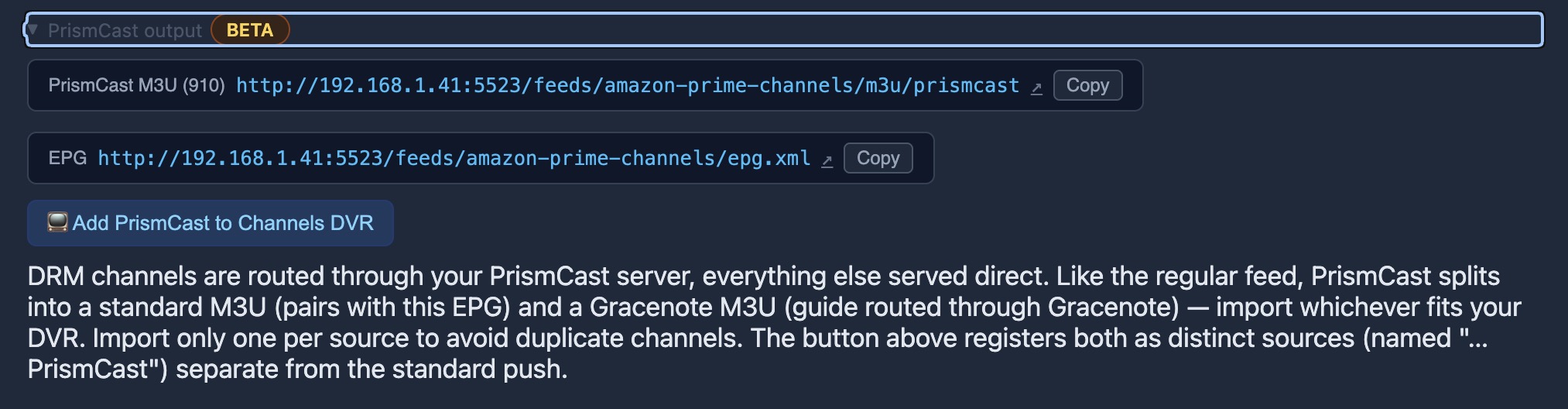

expand the Prismcast output button at bottom - how many does it show there?
It doesn't actually show a number
Yes - u have 910 in that m3u
Ahhh, I didn't see the tiny number in parentheses... however, it's still showing 0 enabled.
The zero is the normal feed (without the bridge). Download that m3u and look at it in notepad - I bet you’ll see 910 channels.
i think I found it - simple UX bug. I assume you had some filter active and that broke my logic for pinned chan num.
The only filter I used was the tick the box for "Amazon Prime Channels" - and you were right, there were 910 channels (well, 750 in channels haha)
Possible but when I remove all filters, it's still showing me the blanks?
got ya-- regardless, my fix will clean it up for ya. tnx for reporting- it's been a long standing bug by the looks of it - just no one reported it.
wow, this bug has been in here for a LONG time too. Simple fix. Tnx for reporting.
I won't be able to recover your missing Gracenote, so you'll have to use bulk actions to turn back to auto, then next scrape should fill them back in.
