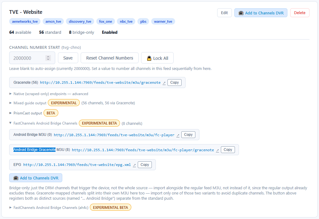

This is actually a bigger problem using Android Bridge. A station I'm not entitled to like NECN now just plays a blank screen forever, so there's no telling where the issue is.
Also, I'm getting the same blank screen for stations I am entitled to, like Bravo Vault. I'm wondering if the source feed is not actually DRM since it's a general FAST station, and that is causing issues with FC Player. It doesn't seem like FC Player can handle when it's not decrypting something, or trying to decrypt something it doesn't know quite how to handle.

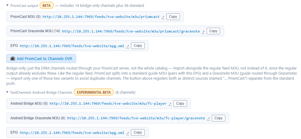

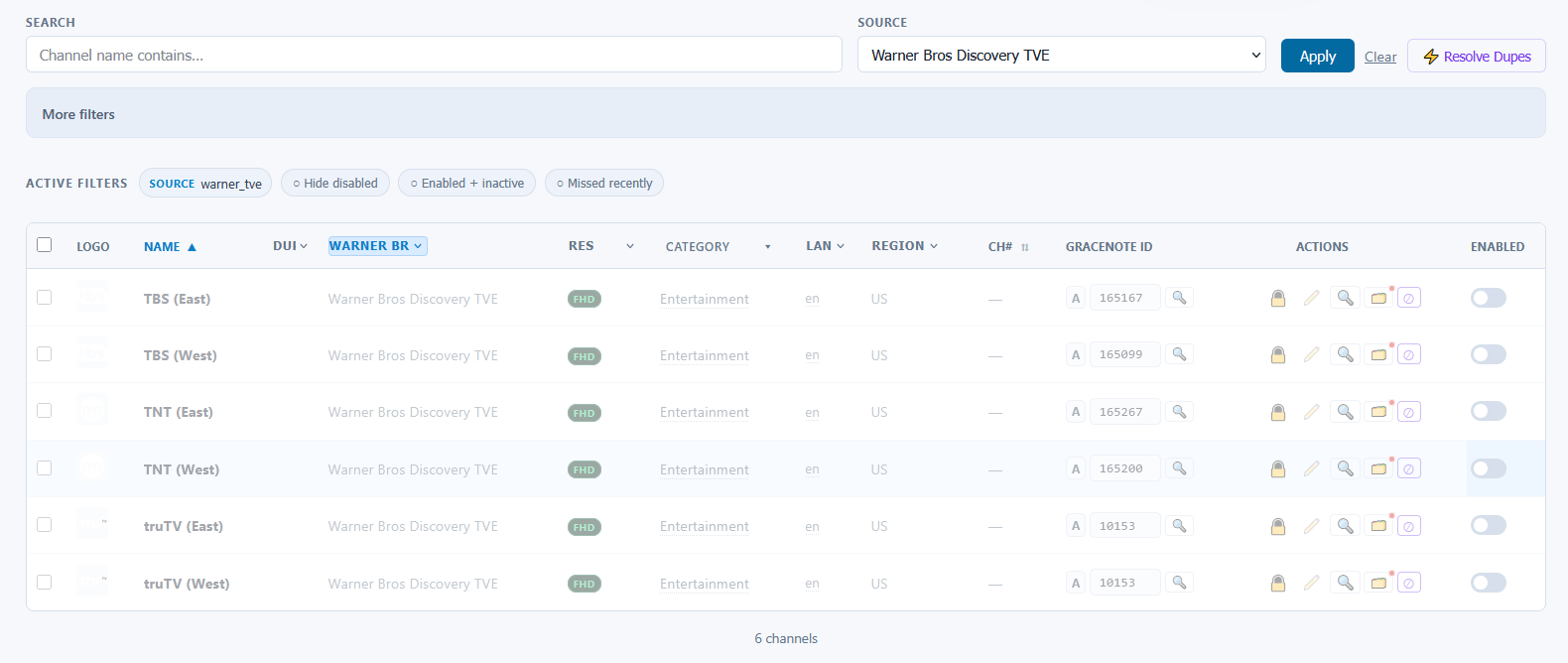

WB is also getting more complicated in that it is showing as bridge available, but only for PrismCast, and not for Android.
This is happening even though the WB feeds that are in here shouldn't be DRM at all, based on what Channels can do.

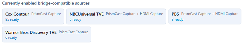

Also, here's what it looks like in healthcheck when I have both Android and PrismCast turned on:
This means I can start a test with these stations that just ends up in the blank screen. On the other side, they won't show up in the Android Bridge feed:

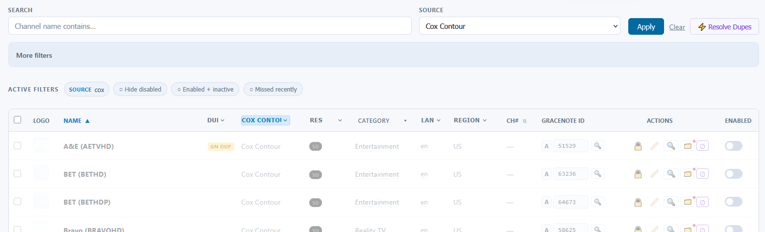

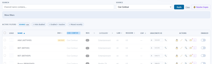

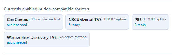

This also happens with Cox, which is a much bigger item (As an aside, Cox is beginning the transition to Spectrum, so there might be some fun changes there). When I turn off PrismCast, FC Bridge looks like this:
However, when I disabled PrismCast, it turned off the stations entirely:
Thus, when I turned PrismCast back on, I had to manually enable all the stations again.

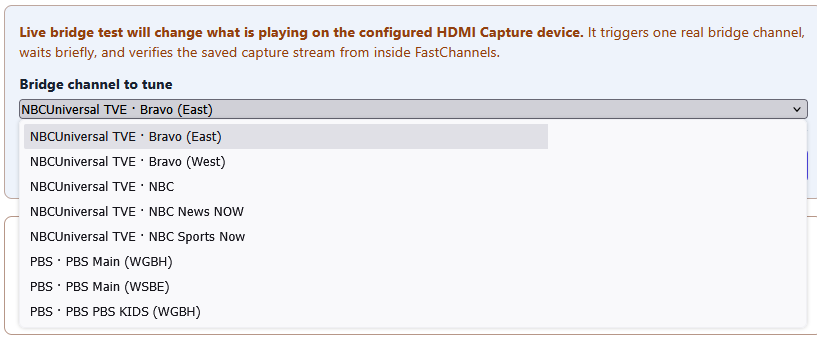

EDIT: And another thing I've just found is that when FC is pretty busy, it can fail doing the launch:
2026-09-12 16:02:46,173 INFO     gunicorn.access: 172.24.0.1 "GET /play/fc-player/pbs/7387eb2c-e0ce-4069-82d9-08865df87edf%3Aga-main%3Ad58dc481-1bd6-44d6-832d-9b51a6339d5a.m3u8?adb=10.255.1.168:5555 HTTP/1.1" 302 247 0s
2026-09-12 16:03:07,754 CRITICAL gunicorn.error: WORKER TIMEOUT (pid:905)
There's no fallback or try again there, so it just does nothing on the Android device.

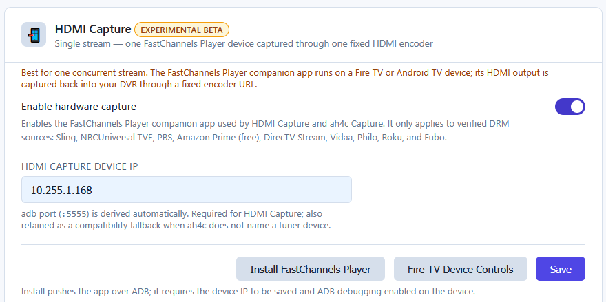

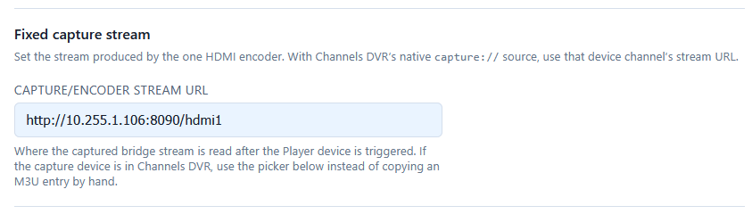

This was unnecessary for me in the 5.2.x versions. When you set up a HDMI Capture device, and do the "Install FastChannel Player", it saves its own working adb_keys.
Note that I only did this with one streaming device, so I'm not sure how well FC will deal with a multi-device setup that isn't being handled by ah4c right now. @KineticMan, the ADBTuner API will allow you to ping the device list, too, so would love to be able to just use that instead to mix in with other ADBTuner stations and use ADBTuner's tuner management. Also, there's a push function to add a feed to ADBTuner's Passthrough function, so that could be the way to handle the connection.
Was not needed, just having the regular single HDMI Capture works the same. As a side note,I set the capture up with my LinkPi's stream...
... and it works perfectly fine when playing directly in clients like VLC. Again, just with a single, so an issue in a multi-device environment, as others have discussed above.
