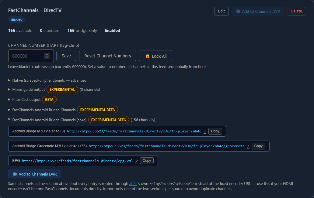

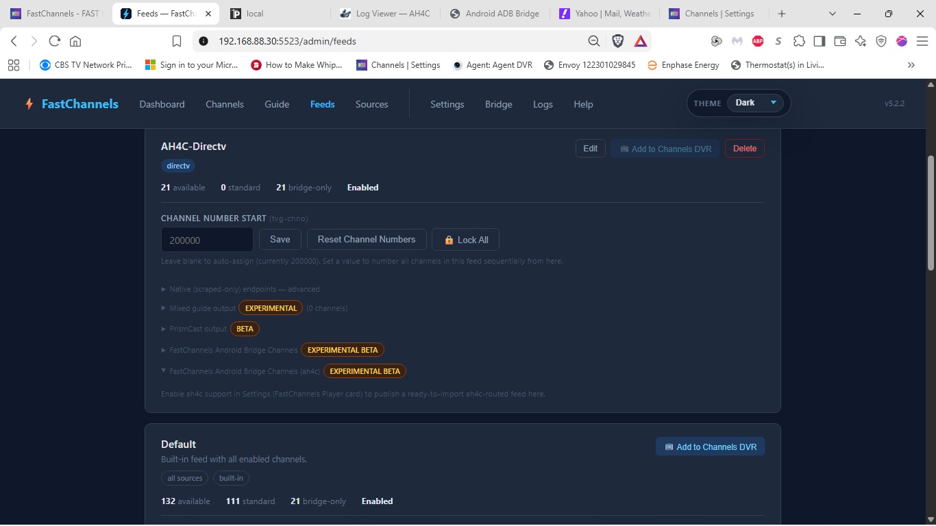

Here's what a proper CDVR Custom Channels Source looks like when using the FastChannels ah4c bridge:

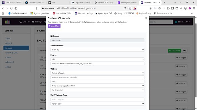

Can you post a screenshot for the Custom Channels Source you're using?
The channel ID in the partial tuning log you posted, isn't the correct format for either the HDMI Capture or ah4c bridge through FastChannels. What you posted is in the <callsign>~<deeplink> format. FastChannels doesn't use deeplinks.
worth mentioning.. I recommend using the "add to channelsDVR" auto function from feeds. theres one for AH4c and one for single-encoder bridge.

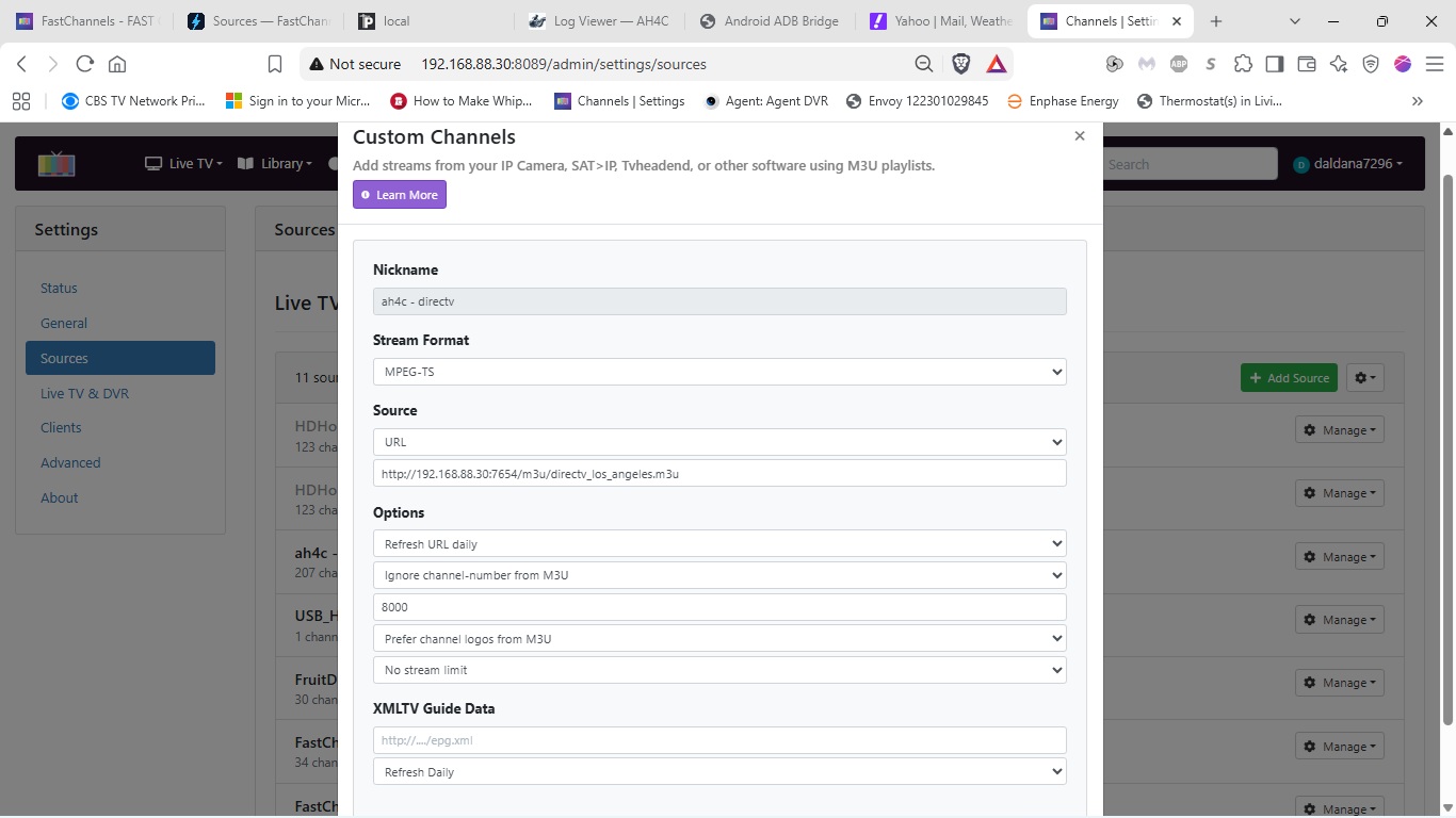

What does the current Custom Channels Source you're using for FastChannels-DirecTV look like? Can you post a screenshot?

Here you go.
That's correct if you're using ah4c by itself. As you can see the Source URL refers back to ah4c for the M3U. The FastChannels ah4c bridge, gets its M3U from FastChannels, and looks like the screenshot I posted. The FastChannels Gracenote M3U you want is found here:
As you can see below, I don't have the options. It must be something with the "stream audit" issue.

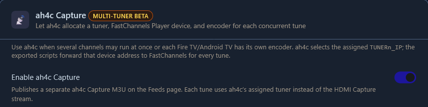

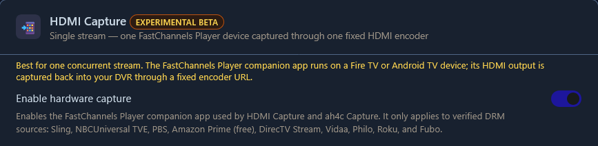

Do you have the both of these required toggles enabled?
I'm pretty sure the first suspect would be your Capture Card.
The above was from post 2759 which seems to say that only one button should be turned on, so I only had the ah4c button clicked on. Having both on now and I have the options available.
A reasonable hypothesis! I bought the HAGIBIS one that was listed earlier in the chat so there should be other users using it as well.

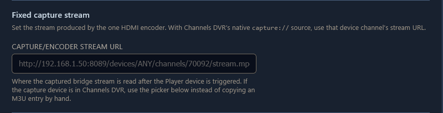

Actually that's referring to this:
or this:
And, I still believe you don't want values in both of those. The toggles though, have descriptions that indicate both are needed.
