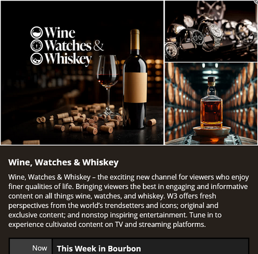

I know that Pluto already has them in the playlist in your fork of the jgomez docker that I'm using.
tvc-guide-title="Bravo Vault"
group-title="Reality"
tvc-guide-description="From Shahs of Sunset to Flipping Out, Bravo Vault immerses you in the drama you love with our rotating content library."
Thank You!
The logic was seeing wine and thought it was a local station call sign fyi.
