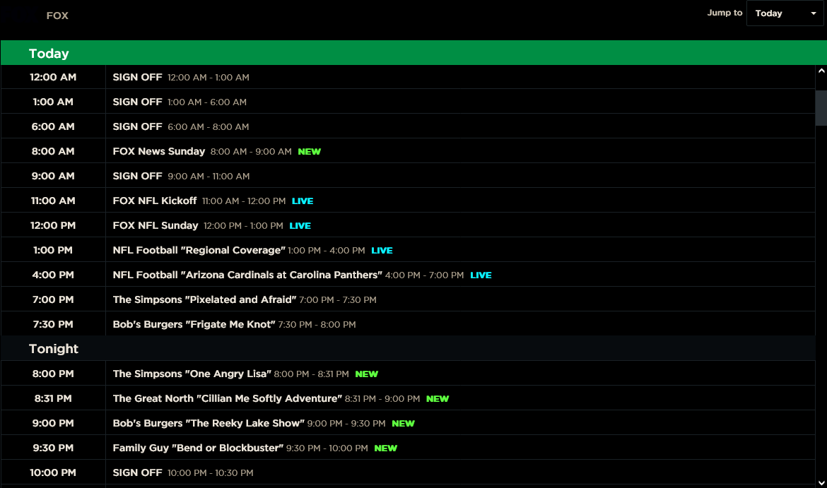

If you're Eastern time it should look like this unless WJW is Fox O&O
The guide shows SIGN OFF (it’s in all caps, that’s not me yelling) for today’s primetime. The guide is messed up for sure.
Same here. Working now. Crazy.
If any of you are getting primetime streaming only on channel 6002 (because your local Fox station isn't Fox Owned and Operated) like me, you should see the same schedule at zap2it.com for the generic Fox channel in your time zone and your Channels DVR guide for 6002 Fox. If not, let the developers know. That's how it's "supposed to work".
Not sure if something was going on with the guide data
I deleted and reloaded the guide (again) and Fox finally worked. Hopefully it’s good going forward.

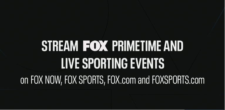

There was just a soccer match on Fox and I was receiving the Stream Fox Primetime and Live Sporting Events message again. Could Fox be doing something on purpose to cause this to happen when live sporting events are broadcasting. I am wondering if this issue is going to happen again this weekend with NCAA and NFL football.

I am receiving the following message but it seems to only appear during live sporting events. I have also received API errors when trying to view Fox. I have submitted logs.

Channels DVR can't play the stream, so it keeps trying to re-authenticate the channel, even after it's authenticated.

Guide shows College Football airing for another 2 hours (19:30-23:00. UTC)
