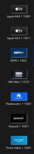

bnhf/olivetin:latest (aka bnhf/olivetin:2026.03.25) pushed this afternoon with channel logos included for use with the FruitDeepLinks/ADBTuner integration.
These are hosted at http://<PORTAINER_HOST>:<SFS_PORT>/<Provider Code>.png:
