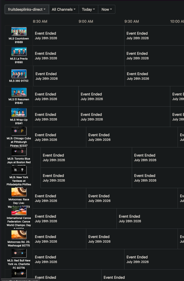

Ok, so I love this project in theory but I am doing something wrong and Im not quite sure what it is. Every time I look for a sport that I know is on it never seems to show up and occasionally manually reloading the source adds it but most of the time it does nothing. Now for instance, I think I should be seeing F1 as its live but all I see are MLS matches from yesterday...
Hey
Not sure what time you have it refresh from the FruitDeepLinks admin portal, but check there to make sure it’s been updating. There’s a manual refresh button too (takes about 300-500 seconds to complete). Also ensure you don’t inadvertently have F1 filtered out.
Then go to CDVR admin portal and refresh the M3U.
Thanks! I did have all the filters correct. It still never showed the F1 live despite it reporting as live in the event. Now that I have looked at it more, I think this could be because I am using the direct link. Ill try the multilink and see if that works better
