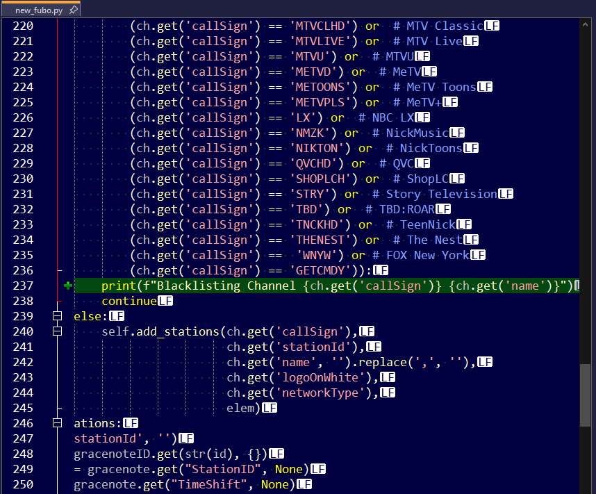

Would be nice if the container could write the list of the channels it blacklisted to a file in the /config directory, like /config/removed-channels.txt

Or just do a print so they appear in the container log

I just modified my fubo.py and added this line before the continue
print(f"Blacklisting Channel {ch.get('callSign')} {ch.get('name')}")
Thank you for the example for printing to the log. I ran with that for now and added a dash and some spaces between the call sign and channel name to make them more easily readable.
