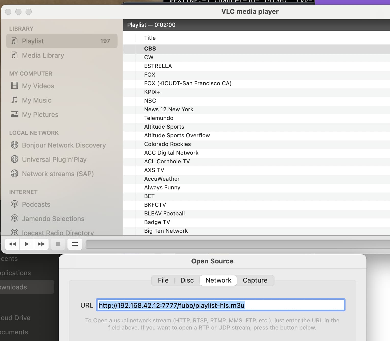

Anyone getting 'context deadline exceeded' when using this script and doing 'reload m3u'?
2025/07/20 23:09:29.694151 [ERR] Timeout while requesting m3u for fubo: Get "http://192.168.42.12:7777/fubo/playlist-hls.m3u": context deadline exceeded
I can successfully load it fine in VLC and watch channels, and curl shows the correct urls, here's a snippet of the playlist:

The URLs definitely load up in VLC:
