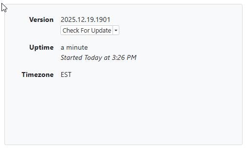

I just got pre-release update for the QNAP ver 2025-12.-19-1901, then tried to add FuboTV after restart. Same message "Login not supported". Submitting my diagnostic logs now.

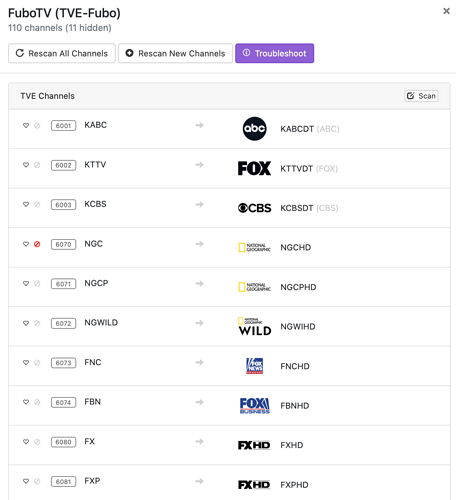

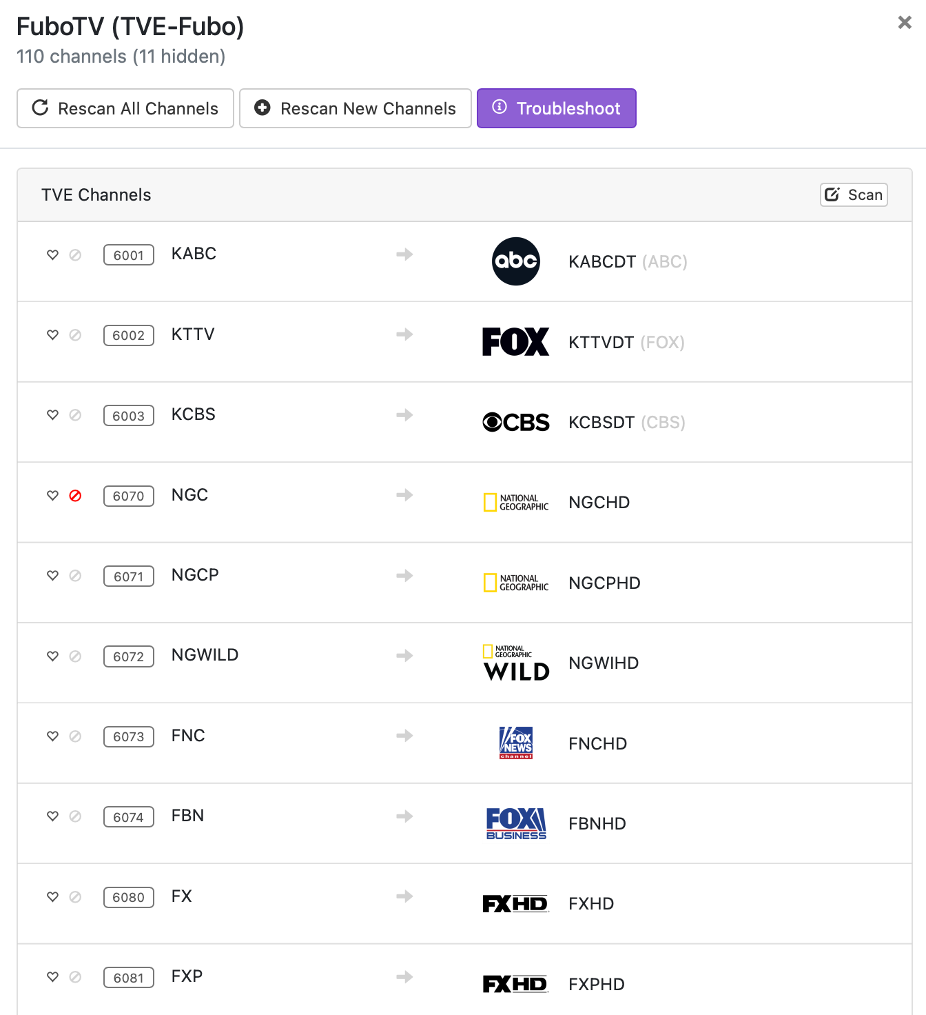

FWIW, I've lost some channels along the way, but the bulk of Fubo channels via TVE is still working for me. I turned off all of my other sources, and tuned into a handful of 600x channels just now, without issue.
Thanks for another point of reference even if it contradicts what I thought was happening.
Thanks for the post.
Even though my Fubo sub is expired, I still get the free TVE channels.
The DVR log proves that I'm tuning to a Fubo TVE source channel.
2025/12/19 15:22:27.766235 [TNR] Opened connection to TVE-Fubo for ch6765 CBSSPORTSHQ
2025/12/19 15:22:27.766292 [HLS] Starting live stream for channel 6765 from 192.168.1.8 (bitrate=9478kbps)
2025/12/19 15:22:29.204162 [HLS] Probed live stream in 1.437538516s: h264 1280x720 progressive 5883520bps
2025/12/19 15:22:29.219165 [HLS] Session ch6765-dANY-ip192.168.1.8 started in 1.452809934s
2025/12/19 15:23:28.499233 [HLS] Stopping transcoder session ch6765-dANY-ip192.168.1.8 (out=1m10.065444s finished=false first_seq=1 last_seq=74)
2025/12/19 15:23:28.522198 [TNR] Closed connection to TVE-Fubo for ch6765 CBSSPORTSHQ

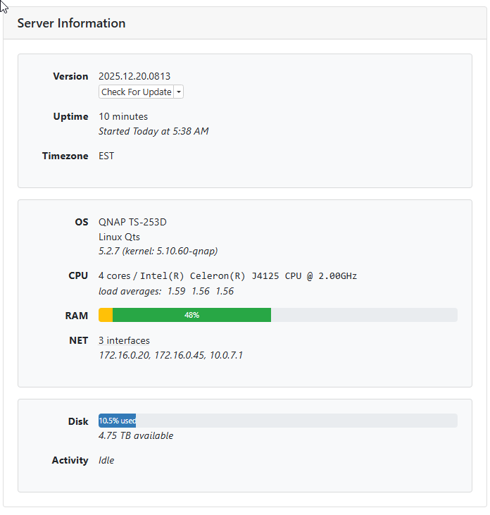

Version: 2025.12.20.0813
Login not supported.
