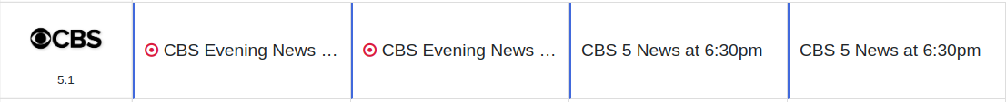

Channels DVR v. 2020.11.18.0042 but I noticed the problem yesterday and forgot about it.
In the attached images, the guide data repeats as if the show is airing again in the next time slot.
From Channels:
From Zap2It:
This is happening on quite a few channels.

Note that after each step to fix the problem, the problem would move; meaning, a different and some same channels were affected with the duplicate show in the next time slot. I realize that some channels air the same show one after the other, but this is not that. In each case I checked against zap2it like the images above.

Is 5.1 on both Locast and HDHR? Are you using the nee Locast channel numbers option?
Awe. Yes I am. Interesting.
Boom! I unselected "Preserve Channel Numbers", rebuilt the guide data and the problem is gone!
