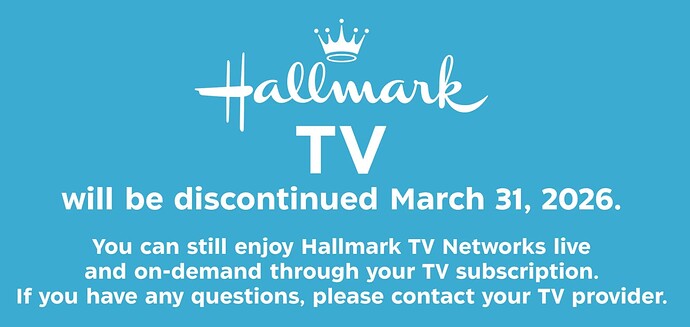

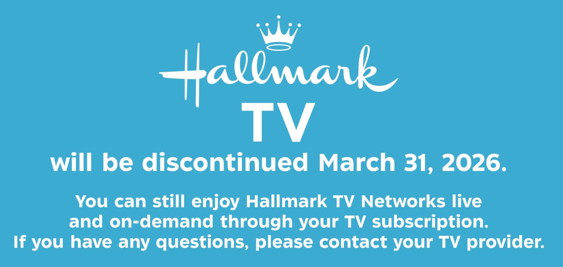

Same issue here with Hallmark and Frndly. I also have Philo and the TV Everywhere versions of the Hallmark channels don't work.
Where did you see this message?
Hallmark TV
FYI, at this very moment, Hallmark TVE still working with DirecTV credentials. We'll see on April 1st.
