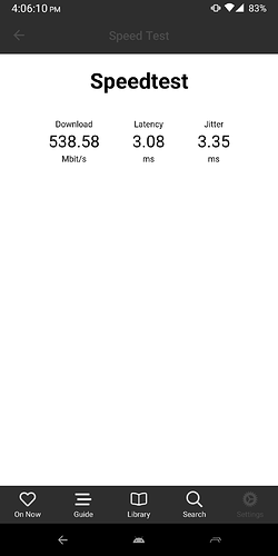

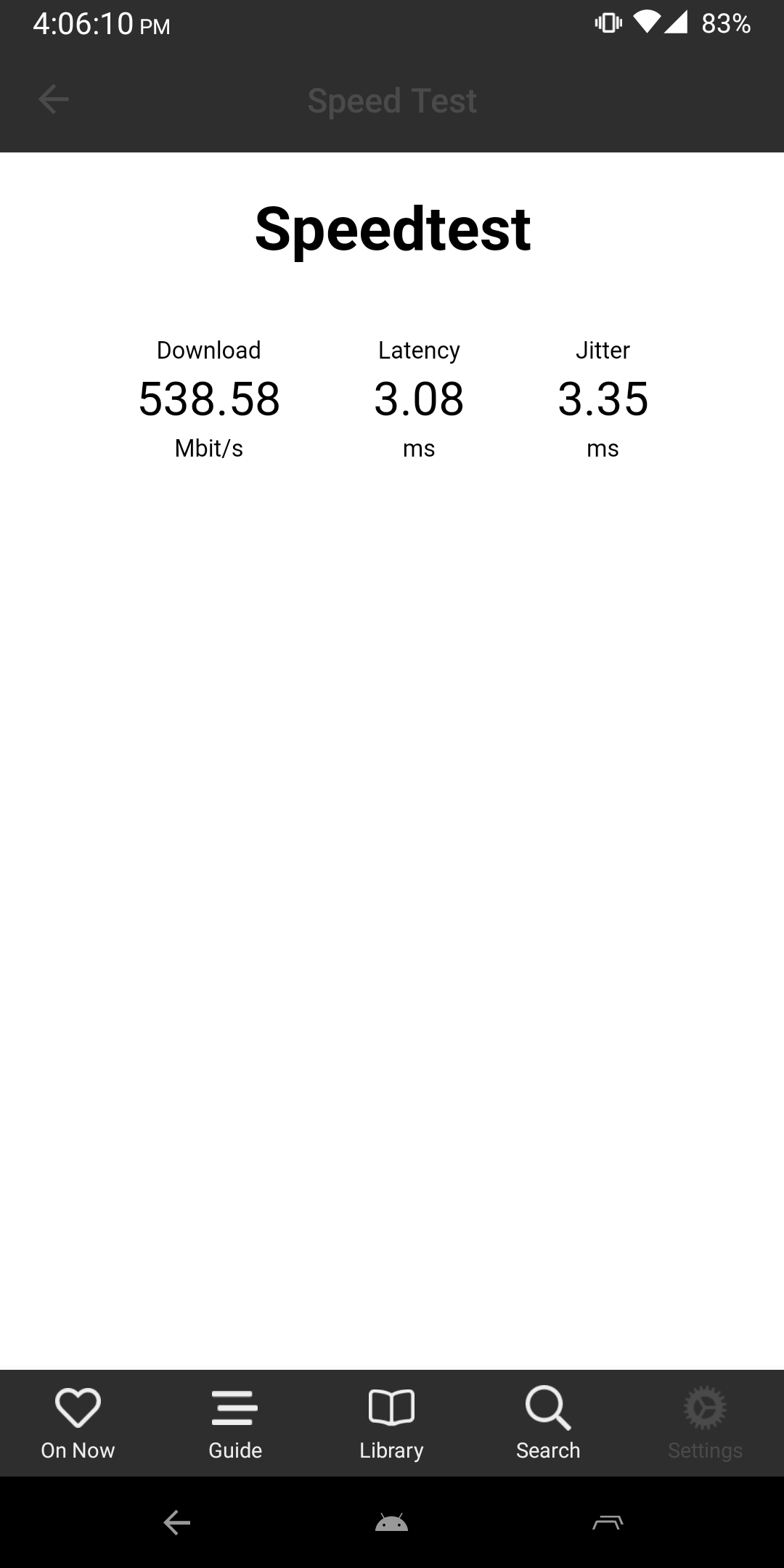

I'd like to put out there that the wifi standard, frequency, etc, has a lot to do with a stable wifi connection. This is 5ghz AC on a phone.
Couple of things to add here. I’m pretty sure the speed test is running between whatever device you are testing from to the Channels client, not from the DVR server. So the speed of the device you are testing from also comes into play. Obviously if you’re able to test from the same device as the DVR software is running on you’ll get a true picture of the speed between them. One more thought on wifi. It’s notorious for being fast one second, slow the next. It’s very susceptible to interference and channel capacity. If your bright happens to do a big download your speed could slow to a crawl. Point is, one test via wifi isn’t going to give you a complete picture. Numerous tests, and especially if you can do one when you’re having issues will give you a better idea. When possible, ethernet is always best. MOCA is a good solution (although not cheap) if you have coax runs.
No, it is between the client device whose IP you have accessed and the server.
