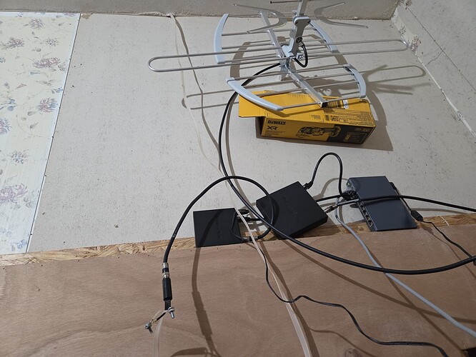

this is my current patchwork
excuse the mess as the house was mostly gutted and remodel still in progress

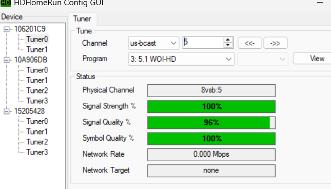

Screenshot 2026-06-22 194037
that old FM antenna works great for 2 channels :slight_smile: so it's connected to the Duo.
now i just need to figure out how to combine a lowVHF with an already combined hiVHF/UHF

yes, I have one mounted on the roof, this was just my patch job til I can mount a proper outdoor one. that fm antennal won't last out there. and actually where i'm at, higher it actually worse. where it's pointed is between trunks of tree's so the signal is more stable. the root of my problem is most antenna's don't do the lowVHF, unless you get a 100mi monster.
