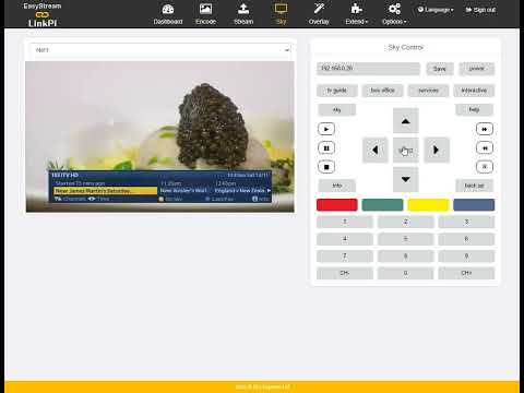

Another perk is possible access to the filesystem. Excellent GitHub info on the LinkPi platform here. I'm thinking of trying to get AH4C to run natively on the box, an idea I got from seeing this video of a STB remote control added to custom LinkPI (see video below).
