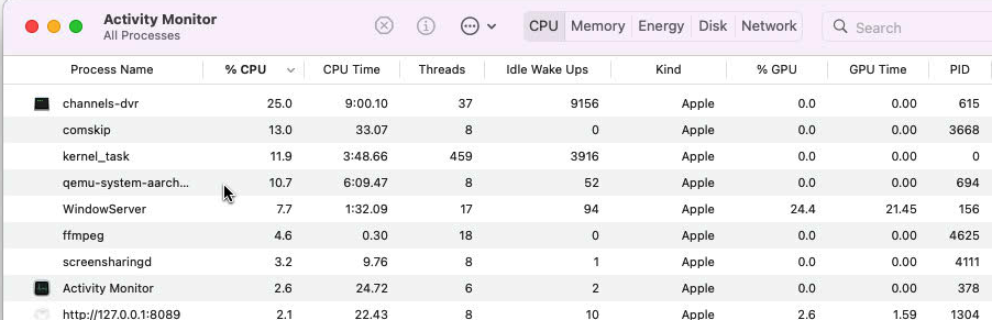

Are you sure you have comskip set to use only 3 threads?
Reason I ask is your performance monitor shows it taking 8 threads.
What does it look like on the DVR web UI for # of threads?
I found if you use the comskip API to set it, it may not appear on the web UI.
I think the web UI only displays 1 to (#cores -1). On my quad core NAS it shows 1, 2 and 3.
With my quad core NAS setting it to 4 via the comskip API doesn't display in the web UI.
You can check a recent comskip log file to see what setting it used.
