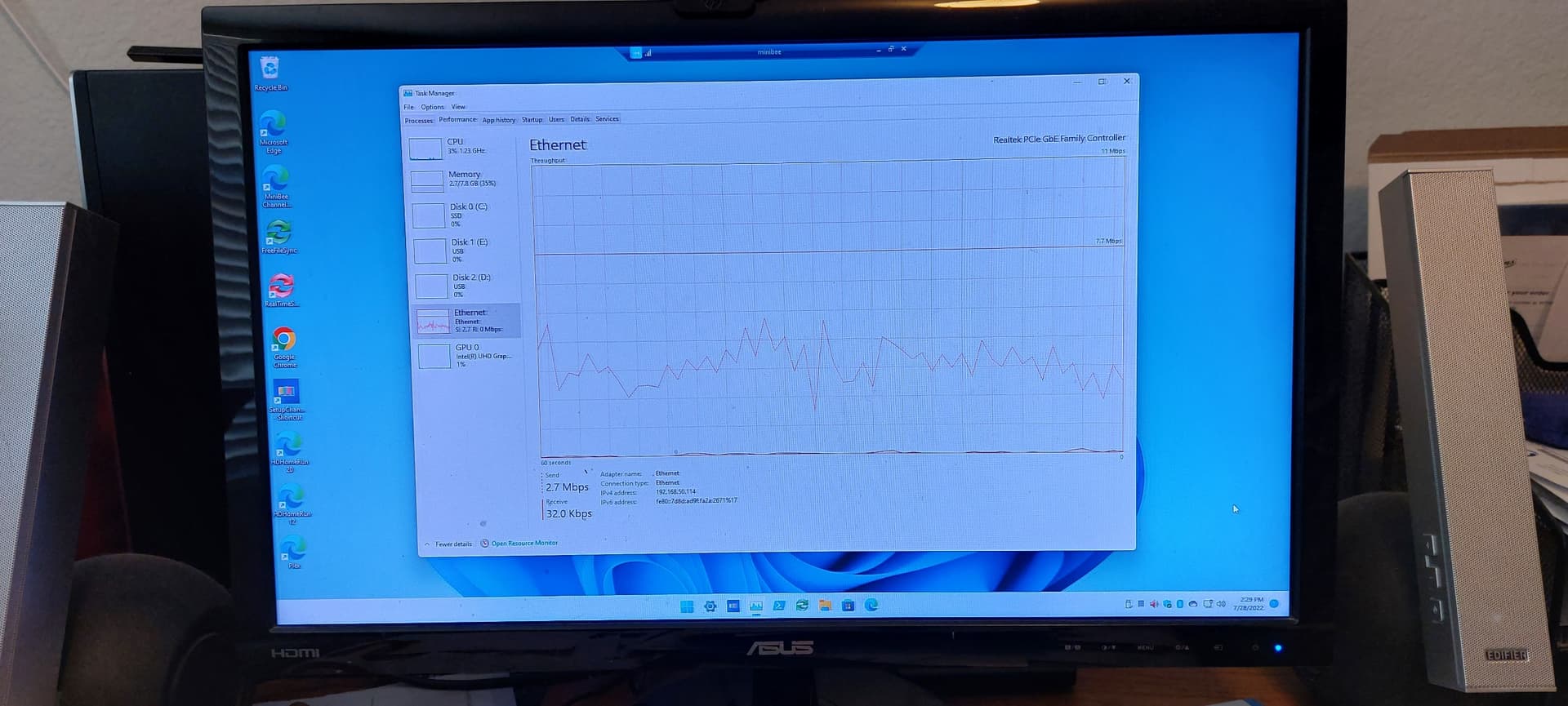

Here is something I found on the server while the same file is playing at basically the same section and the only difference is HLS on or off.
HLS on, excessive amount of data being sent to client, averaging over 200 Mbps:
HLS off, normal amount of data being sent to client, averaging about 3 Mbps.

This is normal that you will see more network usage with HLS: HLS will cache more data locally more quickly to fill up the app's local disk cache (which can speed up seeking). With HLS off, there is no local disk cache.
