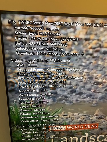

As long as you’re using the app, MPEG-2 isn’t transcoded. I’m remotely streaming this:

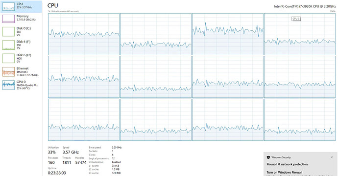

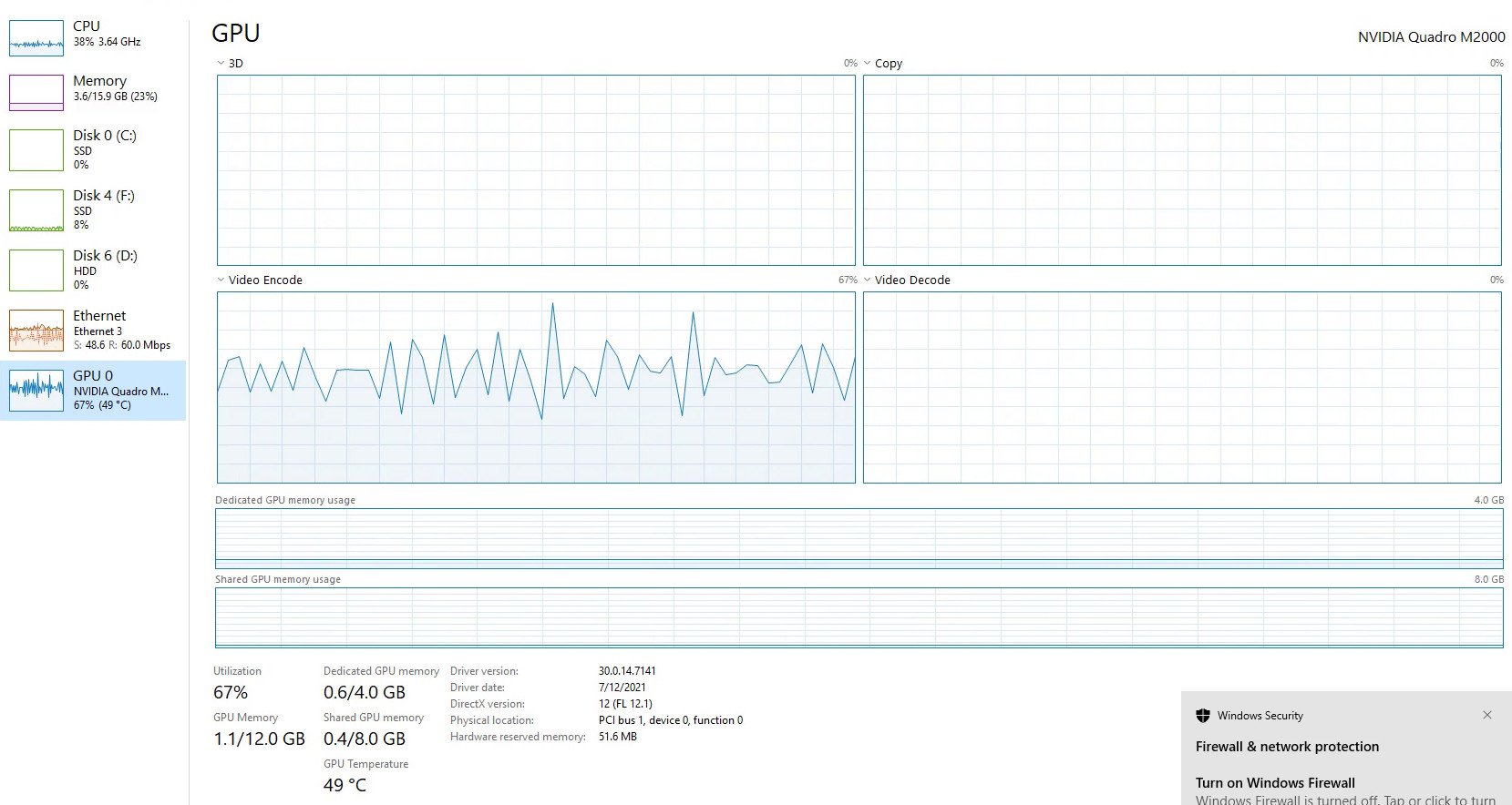

I7-3930K with 16 GB of RAM and an SSD running at legacy SATA-2 speeds. Quadro M-2000 for transcoding. Server is remote - and bear in mind that any time you are watching a channel the DVR is recording it. 100 Mbps up & down VZ FIOS:
Well shoot, that seems like your processor is barely having to work even though it’s transcoding each stream. Are these remote streams or on same network as server?
The server is remote, at my parents house. There's a mountain between me and their viewing area.

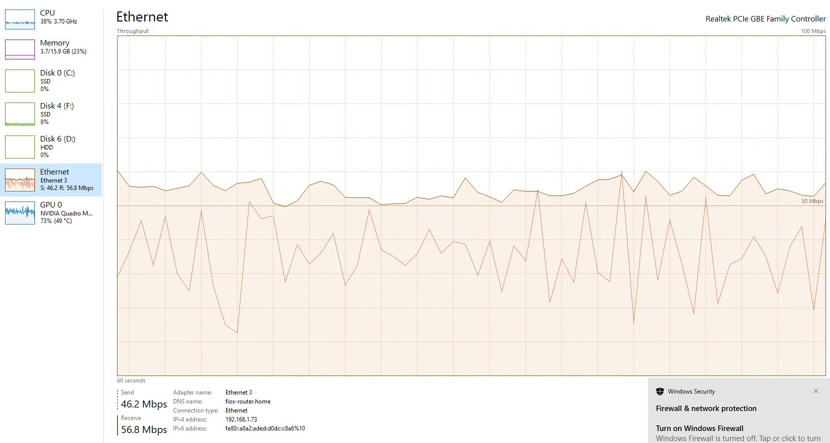

Everything was being transcoded because those were all web sessions. After some recent discussion - and as you can see by the low bitrates of the local channels - I actually stopped transcoding everything as well and set things to stream at original quality, since the normal FireTV and iOS clients we use don't need it (I had been transcoding everything when using Plex for LiveTV because of audio sync issues). As you can see the 100 Mbps upload of their WAN was not an issue, and that was when transcoding everything to 10 Mbps (only 2 of the channels were over 10 Mbps though, and most were less).
I don't have a good way to do a non-transcoding test (I would have to use clients all over the house and I am bandwidth limited to some of those locations) but if you have a good upload pipe it shouldn't be needed. Even if it is, if you unlock the stream limit on your 1050 I would think it would be able to handle 4 streams no problem? It's a Pascal card and has more than enough video memory. Per the matrix posted above it should handle at least 50% what the M2000 can do, and you likely won't need to transcode at all.
