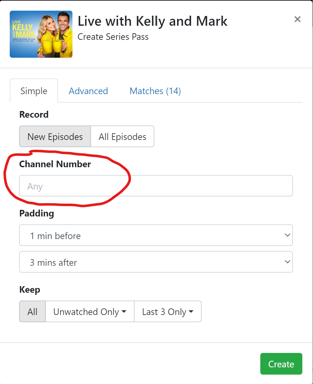

When you create a regular pass by selecting a show from the guide, you can specify the channel number:

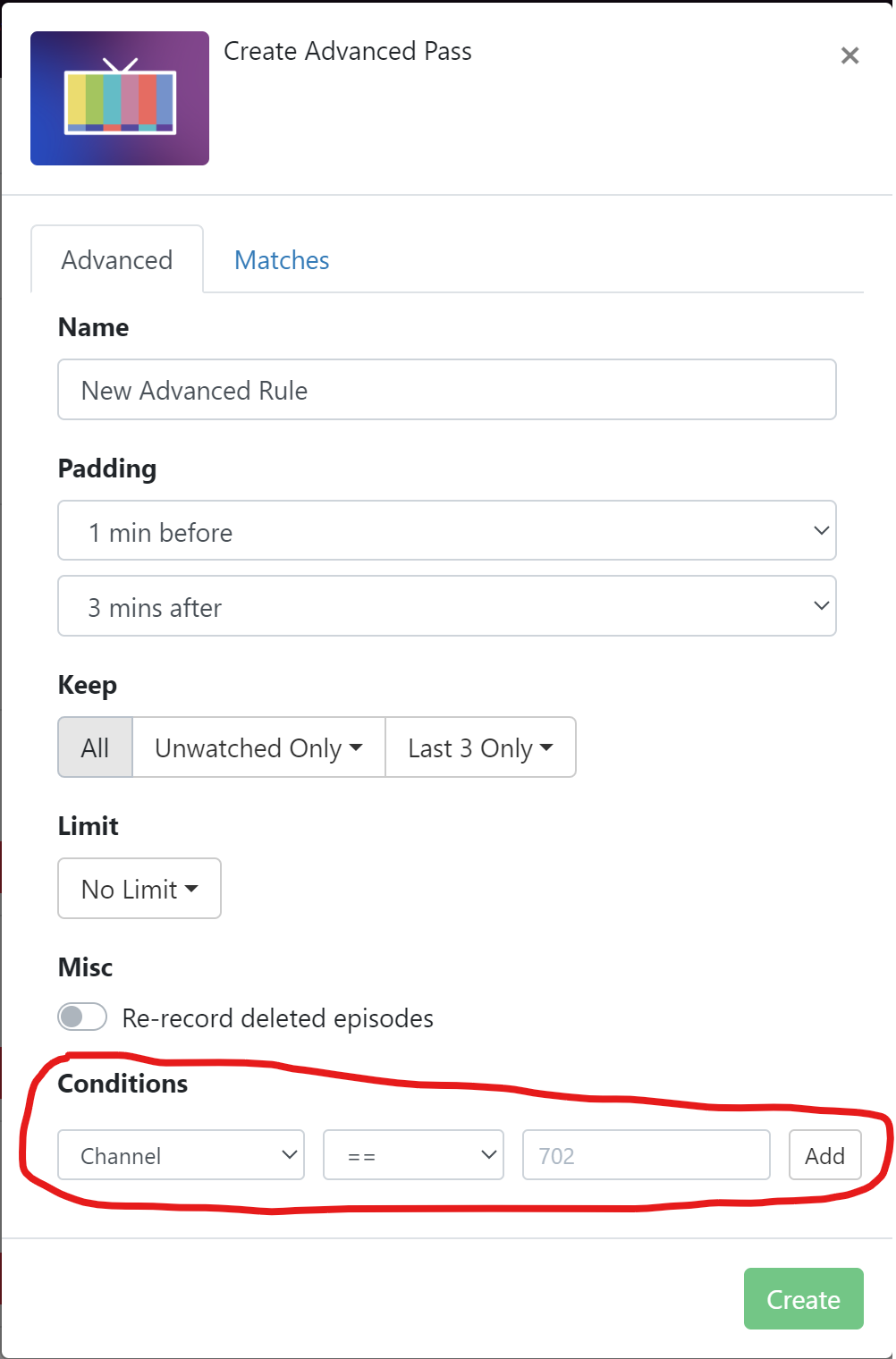

If you create an advanced pass, you can also add a condition to specify the channel number:

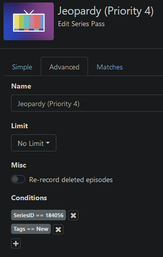

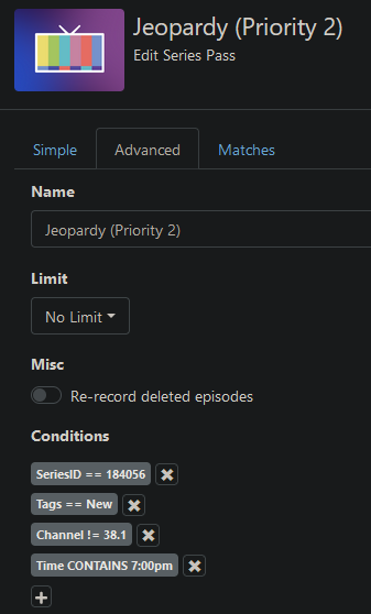

Also consider using Advanced Passes and setting priority there:
Thanks.....I had no clue there was an advanced tab since I use my Apple TV 98% of the time and it doesn't have it. But I found it on the Channels DVR through my desktop browser and that advanced tab certainly will do what needs to be done.
Thanks again.
When I went to edit the pass on my Apple TV...it didn't have channel numbers. But I found the above in my desktop browser Channels.....thanks
