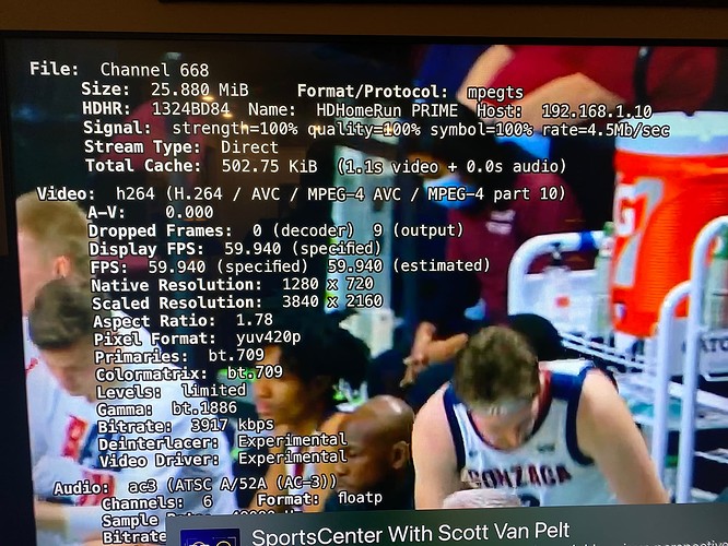

Out of curiosity, what is your bitrate on ESPN-HD as measured by the channel info in the ATV app, and how big is your TV?

I’m on a 65in LG. Took a pic of the stats below.
Looks normal for 720p to me. Most of the channels i got using cable card with the Prime were 720p mp4 streams. Very few were 1080p.

I think it’s possible Comcast is compressing these signals more and more so they can fit more IPTV channels… I swapped back to my TiVo and it’s not really better. This could just be what I get. Crystal clear is not how I’d describe it.
