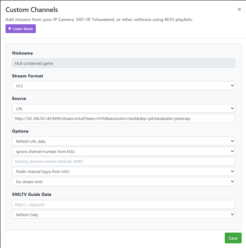

hi Tony, thanks so much for this recommendation, my thoughts are once I get this working, I can set up a daily recording at 1am or something to record yesterday's game with the skip pitches setting, and then I can watch and resume it as my leisure using Channels!

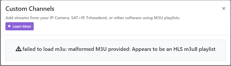

but I can't get it working. I'm trying to add it as a Custom Channel via URL
and I'm getting an error that says failed to load m3u: malformed M3U provided: Appears to be an HLS m3u8 playlist

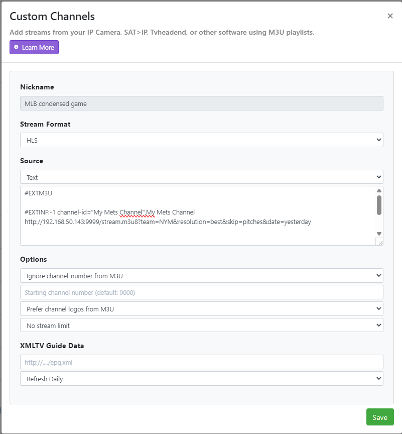

next I tried entering it as Text using the following:
#EXTM3U
#EXTINF:-1 channel-id="My Mets Channel",My Mets Channel
http://192.168.50.143:9999/stream.m3u8?team=NYM&resolution=best&skip=pitches&date=yesterday
But it doesn't work when I try to view the stream using Channels.
Any advice?
The text source looks like it should work, but I don’t use Channels, so someone else might have to chime in to confirm.
The example URL I gave from mlbserver is the direct m3u8 stream link, rather than a m3u playlist link, so it’s understandable that trying to add it as an m3u URL in Channels would fail.
