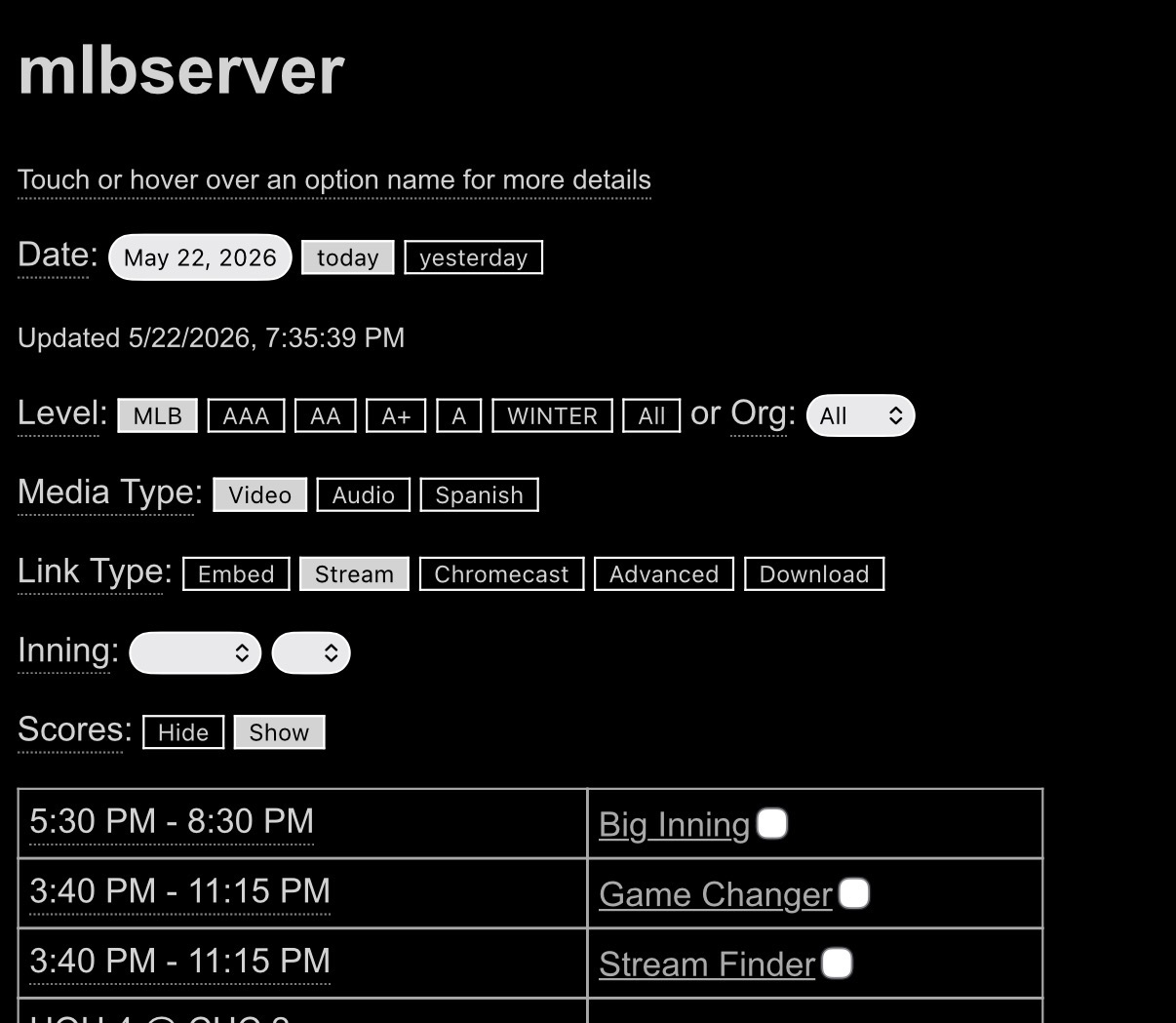

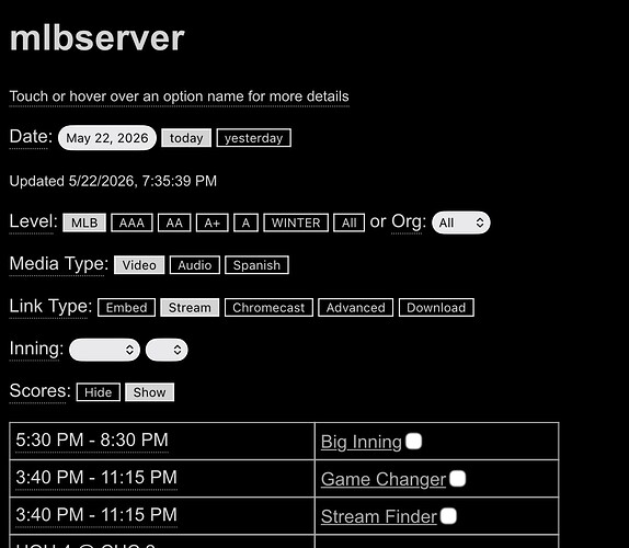

For me on the last two nights both Game Changer and Stream Finder show in the mlbserver webpage as available but only play the β€œevent about to start” loop. Big Inning works.
Thoughts?
long time occasional lurker, someday i'll retire and can watch baseball all day. thought ya'all might be able to help.
This Game Changer / Stream Finder bug is fixed in version 2026.5.27
