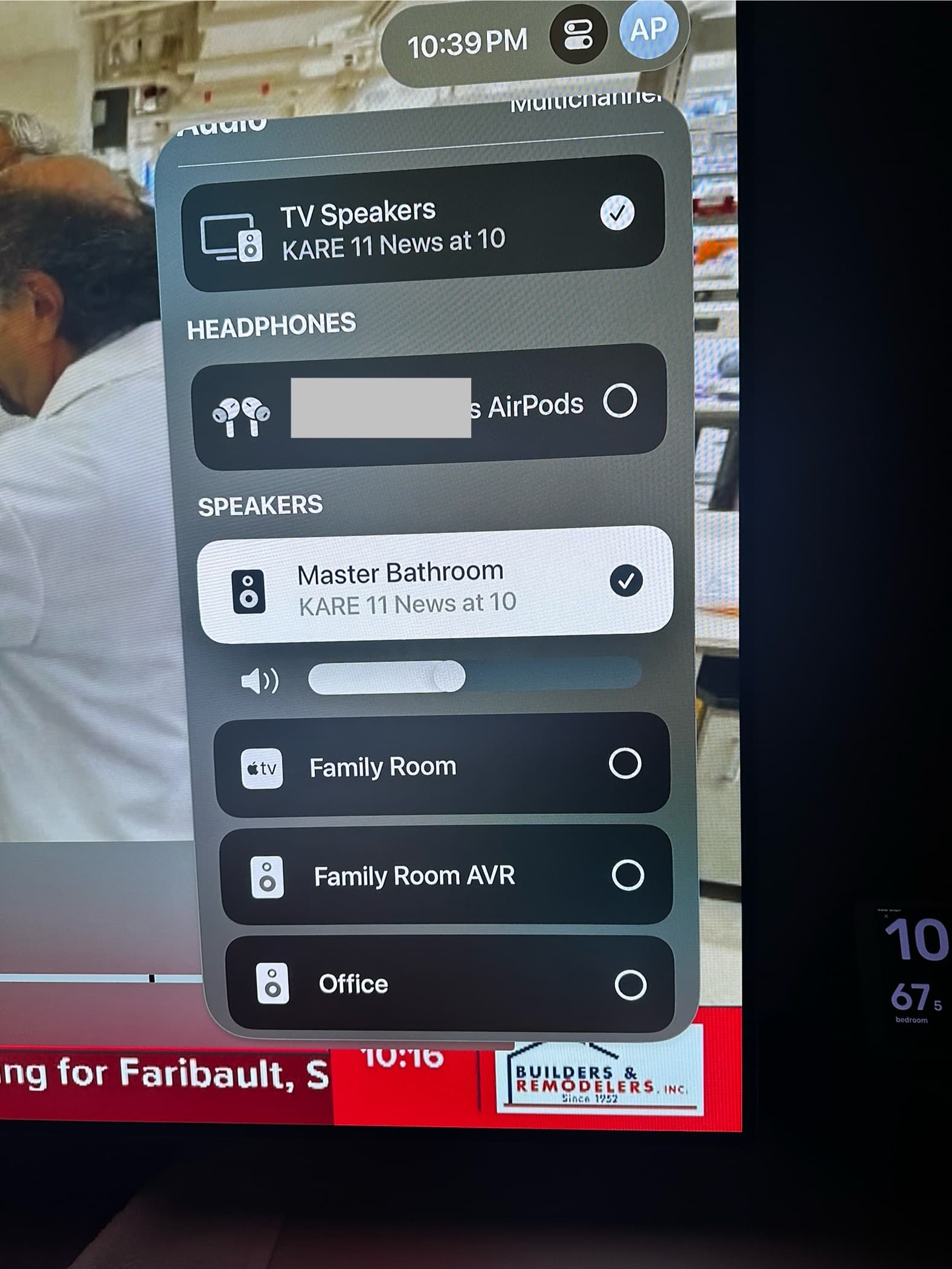

I am attempting to have the audio play through the built in TV speakers via the HDMI cable and to an external AirPlay speaker at the same time. (See the attached image.)
This works perfectly when I stream shows from the Netflix app. When watching a show from the Channels app, the show audio only plays through the Airplay speaker. Navigation sounds play out through both the TV speakers and the AirPlay speaker.

I tested it again, this time with two AirPlay speakers and the local speakers via HDMI. The audio played through both AirPlay speakers, but not through the local speakers. I then performed the same test with the Netflix, Philo, Prime Video and Plex apps, and they all worked as expected. The only Channels setting I could find within the Channels AppleTV app is for the Audio Driver, which is set to Default.
