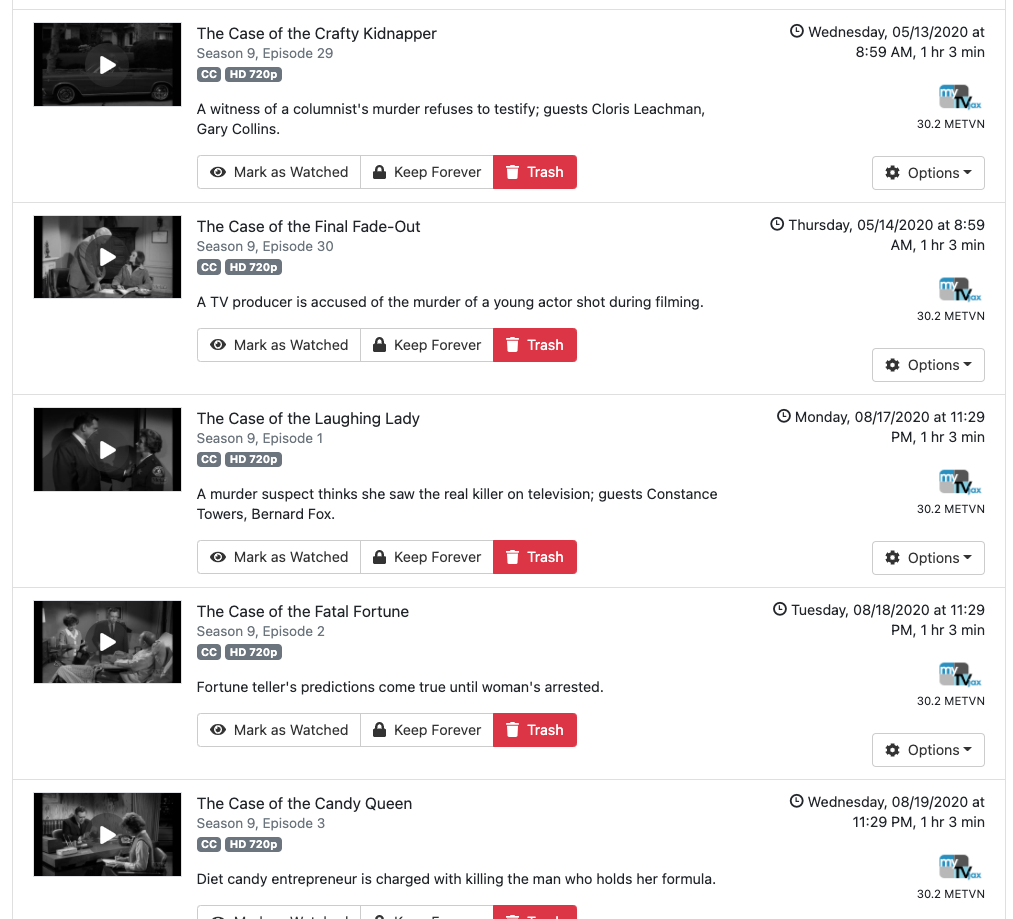

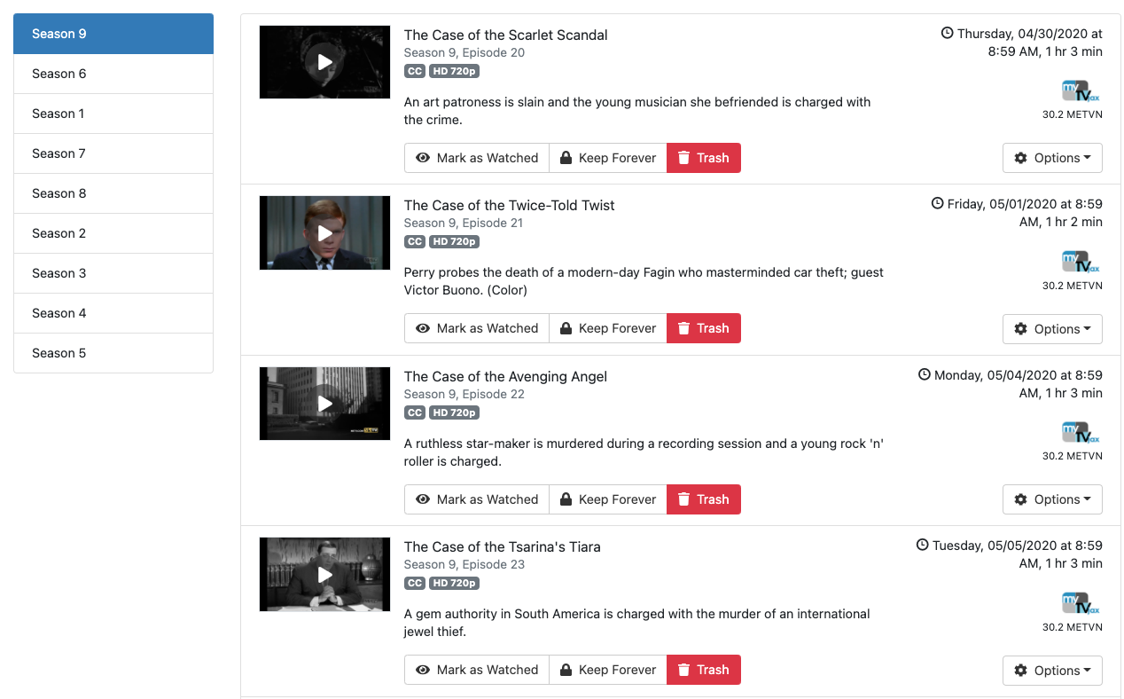

Hm Possibly... Here's an example of a show with way more than 10 episodes per season. Notice both the season buttons on the left (first pic) and the episodes (second pic) seem to be following "date added" sorting:

For some reason it seems to be sorting by recorded date, not aired date. And no, I do not see any easy or visible means to modify the sort order.
This is one of the new bugs/UX faux pas that have occurred since breaking out the Library in the web UI.
It is the same issue. Things are supposed to be sorted by episode, but are being sorted by added date. When importing content, the filesystem returns items in alpha sort so the created at dates for those imports are in the sorted order: S9E1, S9E10 etc
