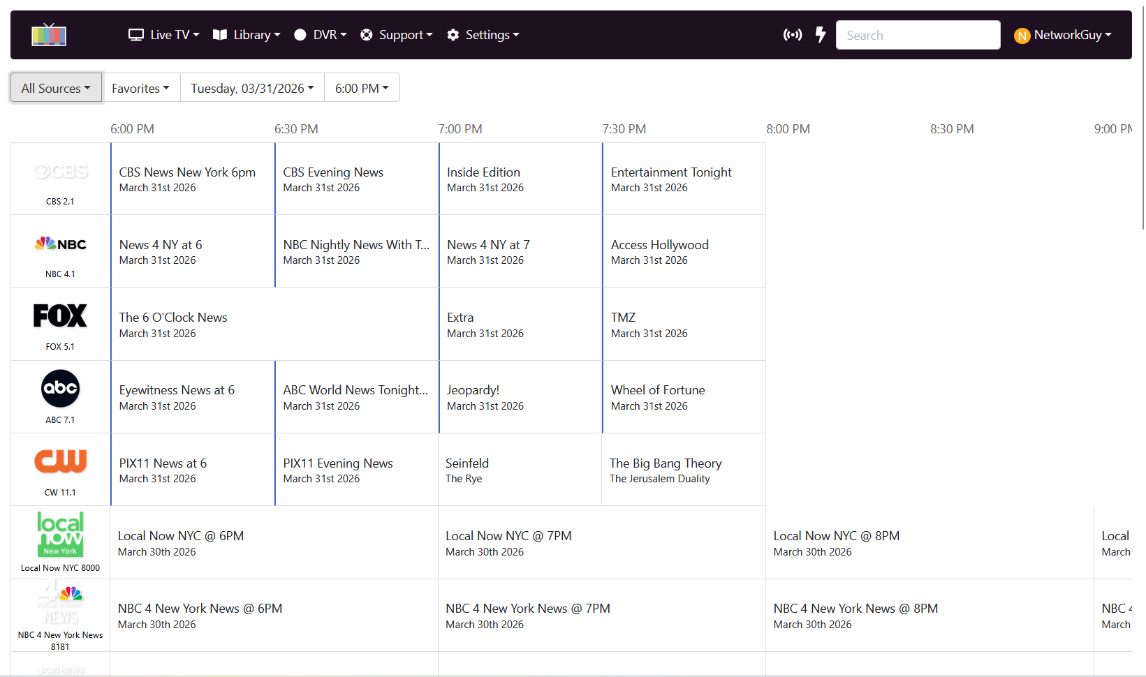

I was looking forward at the guide data and noticed that it stops at 8pm on 3/31 for my HDHomeRun tuners. I re-downloaded the guide data and there is no change.
Suggestions?
There is no guide data to download. It ran out. Check your DVR log.
reached end of available guide data

So who is responsible for "refilling it"? :confused:
that's 11 days from now-- that may be as far as CDVR goes out
It's happened before. Eventually Gracenote will get around to filling it in.
There's also the issue of when they fill it in, will it be accurate
Unfortunately we know it will only be close to accurate. It's not an easy task as things are always changing.
Seeing guide data out to 4/5 this morning.
Mine updated overnight. I'm seeing till 4/5. Try downloading manually if it is not caught up.
I just got back and checked, I have data until 4/6. :grinning:
