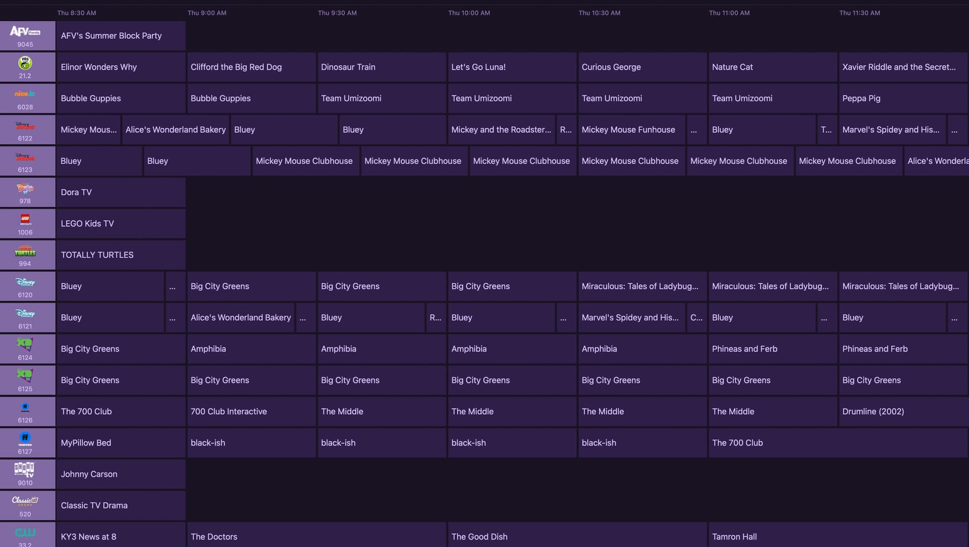

I am fairly new to Channels, and decided to set up Pluto TV using the nocords epg. Unlike some of my sources, I'm seeing large holes of missing epg data on Pluto channels if I look ahead 23+ hours (screenshot below). Is this to be expected, or should I try something on my end? Here's what I have, and what I've tried so far:
Running Channels v2022.05.25.0242
Pointing to https://nocords.xyz/pluto/epg.xml (and https://nocords.xyz/pluto/playlist.m3u)
Refresh every 3 hours
I have tried restarting Client. I have tried fetching guide updates on Server, then restarting Client. I have tried re-download entire guide on Server, then restarting Client. I have tried using https://nocords.xyz/pluto/epg.xml?cb=8675309 as recommended earlier on in this thread.
PS - The other holes shown in the screenshot are Stirr channels, also from nocords (https://nocords.xyz/stirr/epg.xml)
Thanks in advance.
You're seeing all the data that's available.
12 hours tops for me looking at my android client. Used to be 8. On the bright side, you can record, which you can't do on the Pluto app. No subtitles either.

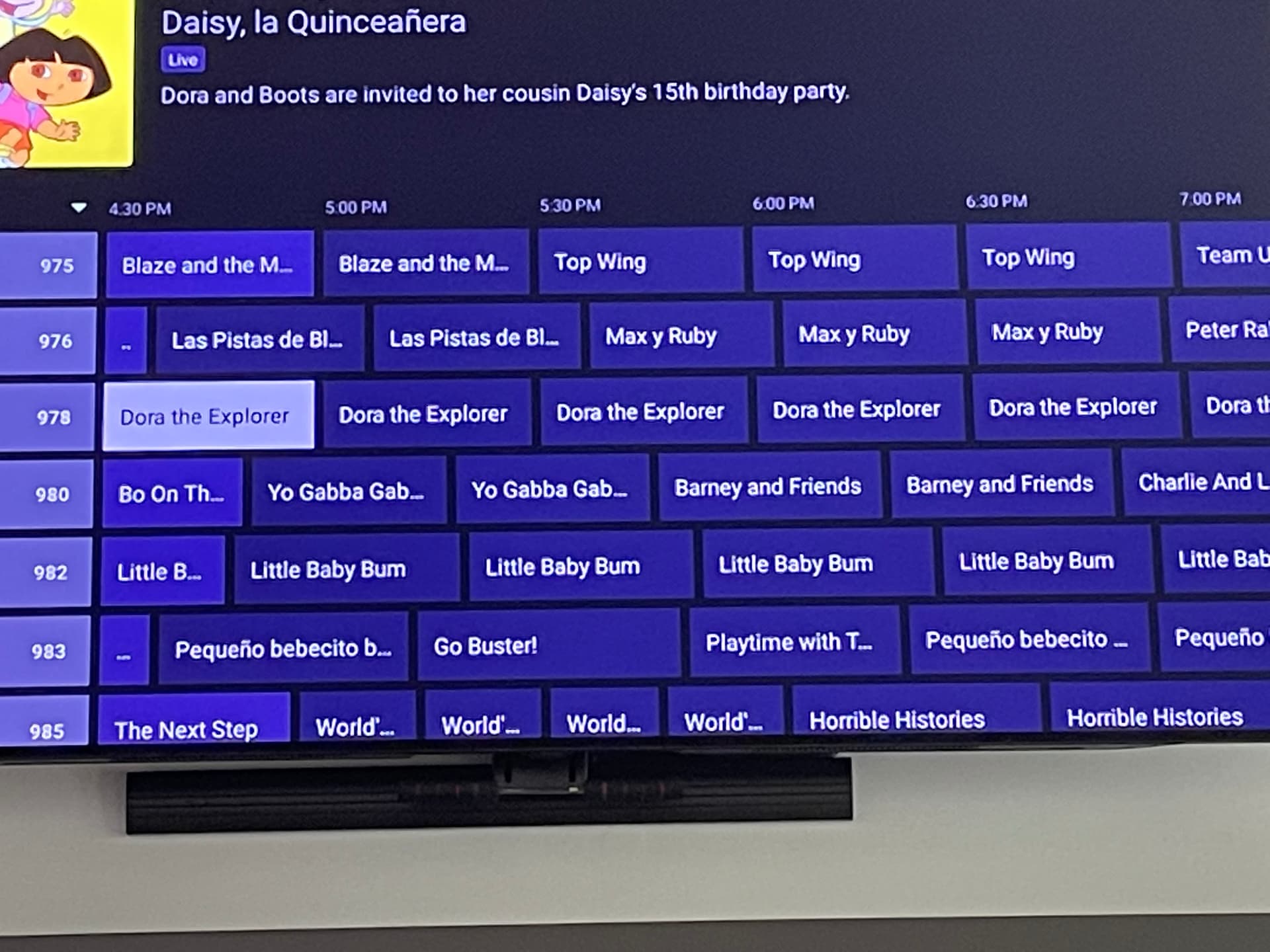

While itβs possible that this is all the data that was available at 9am, I have noticed this behavior when you have multiple sources with two different channels using the same channel number. ie check to see if channel 978 Dora on Pluto is also say 978 nasa on another source. Are you showing data now?
Overlapping channel numbers are not supported by Channels. It is your responsibility to make sure they're unique.
@Rice Thanks but I did not find any duplicate channel numbers
@jkr4m3r and @tmm1 Update: I see that the holes have moved ahead now, and are showing around 1pm tomorrow (originally were around 9am tomorrow when I took the screenshot). In other words, more data has filled in and another 4 hours of programming is visible now - leading me to agree that I'm receiving all the data that is available when updates occur.
Custom Channels > Edit Settings > Options > Ignore Channel Number From M3u
I use to have them selected as "Prefer channel number from m3u". But when I used to have 20 sources (only running 4 sources now) I ran into duplicate channel numbers.
Telling Channels to ignore channel numbers let's Channels DVR assign channel numbers. You won't get overlaps.
