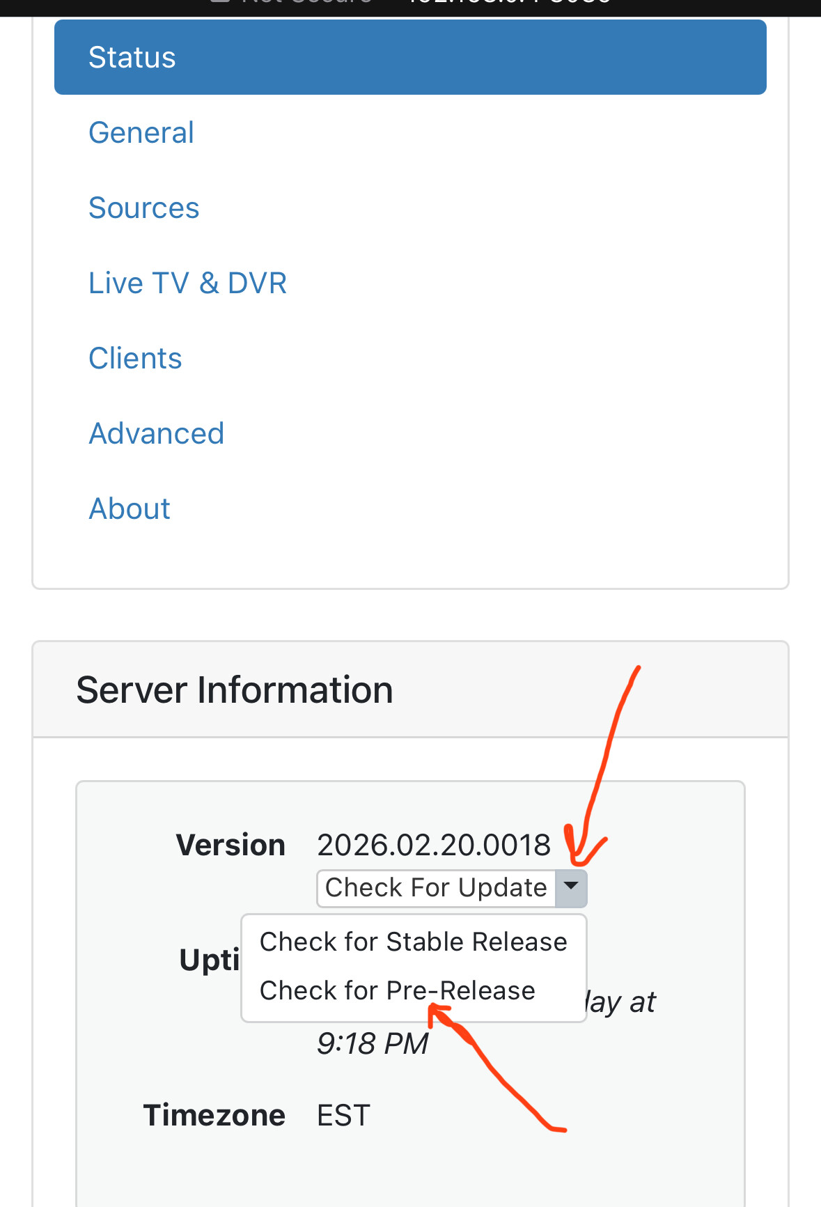

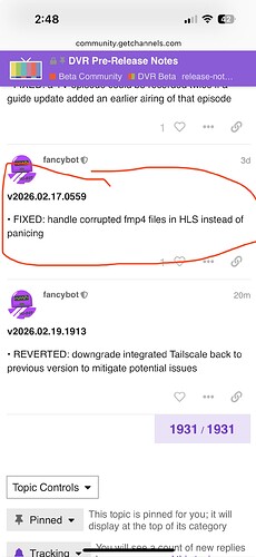

If you feel it's the same problem, did you try the solution described in the post a couple above yours?
  1. update to the latest prerelease version.

Ah, I understand now. No, that was not the problem. I was able to upgrade the container using the Server Information pull down. After that, it began to work.
