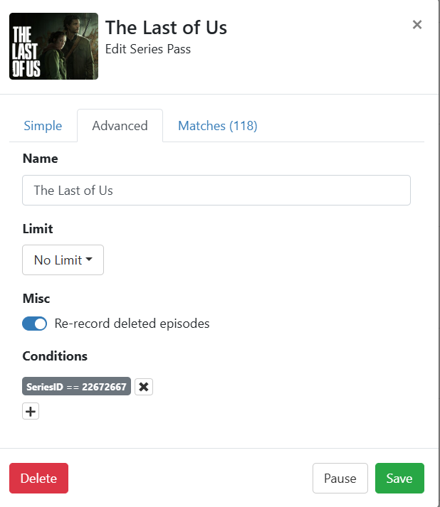

Hello! I have been using the "Mark a Movie or an Episode for Re-Recording" action quite often lately. It seems that some series on Pluto do not always begin at the correct time. This results in recordings which are cut off at either end.
There have been so many problematic episodes in one particular series I have recorded, that I would love to have a way to flag the entire series for re-recording, rather than one episode at a time.
Would it be possible to have an OliveTin action to "Mark a Series for Re-Recording"?
Just make your pass to re-record deleted ... That way if you delete a bad episode it will re-record.
