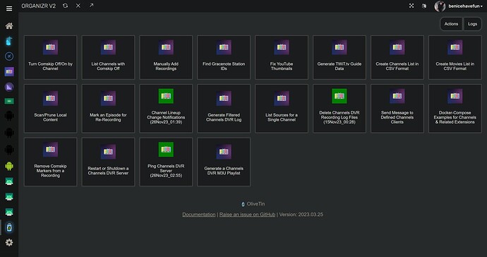

I'm working on an "M3U generator" of sorts for Channels DVR using OliveTin. The idea is to both create an M3U using a Channels DVR as the source and curl the results all in one operation. I'd like to get some input on anything I should add to this, but here's what I've done so far:
Are there other options that should be included?
EDIT: Added true/false field for "abr" (Adaptive Bitrate), and "duration" for generating matching optional URL for XML guide data spanning x seconds.

New OliveTin-for-Channels :test tag build pushed that includes the M3U generator described a few posts back:
The M3U can be seen in stdout, but is also output in ready-to-use form in /config/data. If desired you can host the data directory using the static-file-server container. This gives you a URL you can use on your LAN or Tailnet, and would allow for hosting an edited version of the m3u:
