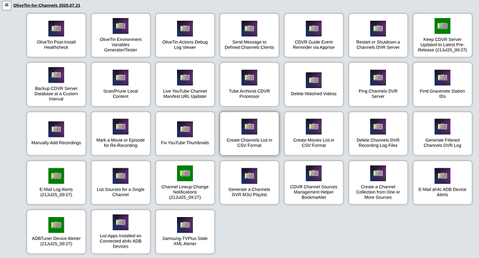

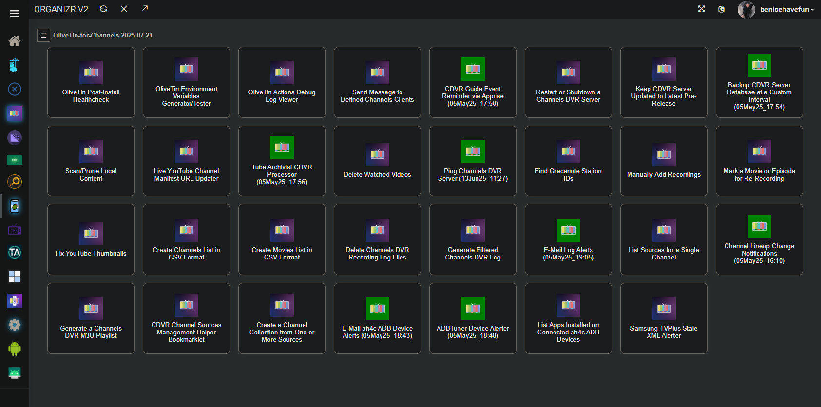

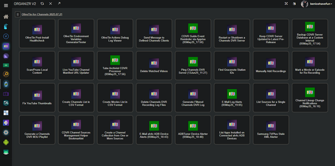

@jsfullam Are you seeing the usual green icons for all of the OliveTin Actions you have set to run on an ongoing basis?
Like so:
Yep.

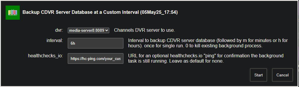

Setup a new one like:
You can leave the healthchecks.io value as the default. Click Start then refresh the browser after the Action window closes. Does its icon turn green?

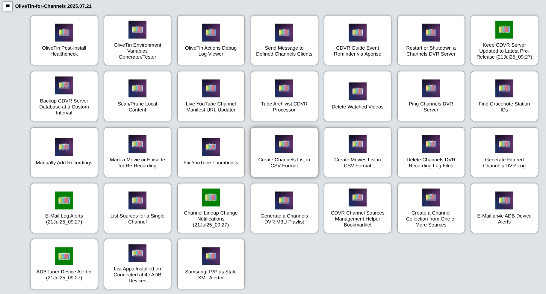

Yes, the icon turned green. config.yaml shows a new "date modified" time coinciding with the new action start time.
Screenshot 2025-07-21 3.52.03 PM

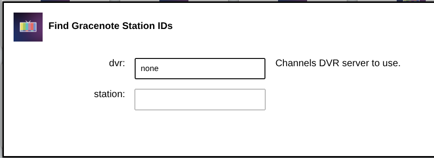

Looking again at that config.yaml file, what does the very first Action OliveTin Post-Install Healthcheck show for the dvr argument?
Mine:
      - name: dvr
        description: Channels DVR server to use.
        choices:
          - title: media-server8:8089
            value: media-server8:8089
          - title: utheater-pc:8089
            value: utheater-pc:8089
          #lastchoice
        default: media-server8:8089 #dvr default

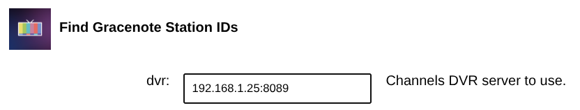

From my main system, which is having the problem:
- name: dvr
        type: very_dangerous_raw_string
        description: Channels DVR server to use. #healthcheck dvr description
        default: none #healthcheck dvr default
And from my backup system which runs an older version of Olivetin, seems to be ok.
- name: dvr
        default: 192.168.1.25:8089 #healthcheck dvr default
Screenshot 2025-07-21 5.54.19 PM

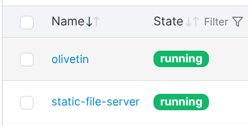

Is it possible you're attempting to use OliveTin before the container is done starting-up? It takes a little longer for the start-up when you have several recurring Actions configured.
I would suggest stopping the olivetin stack, then start it again followed by watching the olivetin container log in Portainer until you see it finish the boot process. Then check to see if this issue persists.
If it's still an issue, we'll probably need to coordinate on another remote connection, as something is keeping your config.yaml file from updating properly. It's nothing I've ever seen, or had anyone else report.
I always wait at least until I see this:
