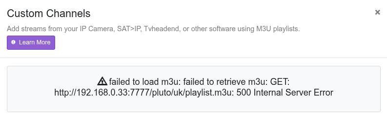

Is this still working for the UK feed? When I try to add the custom channels for UK I keep getting the error "500 internal server error" The US east & west work fine for me. The log shows it requests an m3u and generates an epg for UK, I can't verify that it did so successfully. I am running the latest version.
I'll look into it.
I found the issue and will have an update soon.
v1.2.3 is released with the UK IP fix.

Did that fix your issue?
Yes, that works! Thanks!

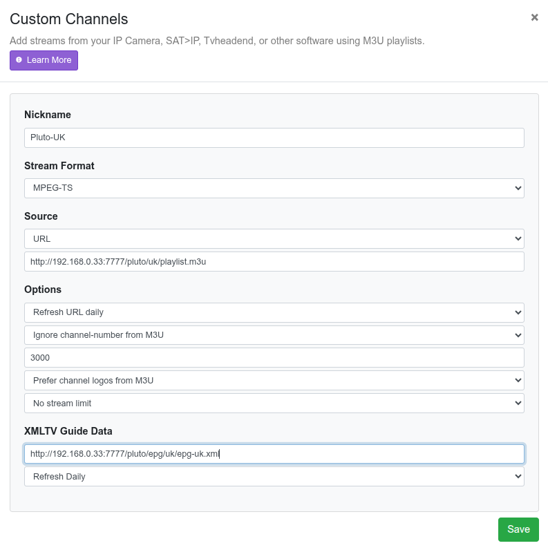

It seems like the transition to commercial breaks still act flaky on the UK channels.
I do need to go back and make sure that I am using transport stream setting.
Make sure you are using Mpeg-ts and not HLS in the custom channel settings.
Bobby, should the Tubi Bridge program source also be set the Mpeg-TS? I assume so, since it's just like the Pluto one.
The only reason I set Pluto to Mpeg-ts is because of the way Pluto injects commercials. Setting it to Mpeg-ts allows Channels DVR to remux the stream and helps to overcome some of the freezing Pluto experiences during commercial breaks. Tubi doesn't seem to have that issue.
