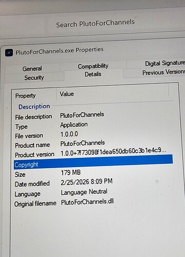

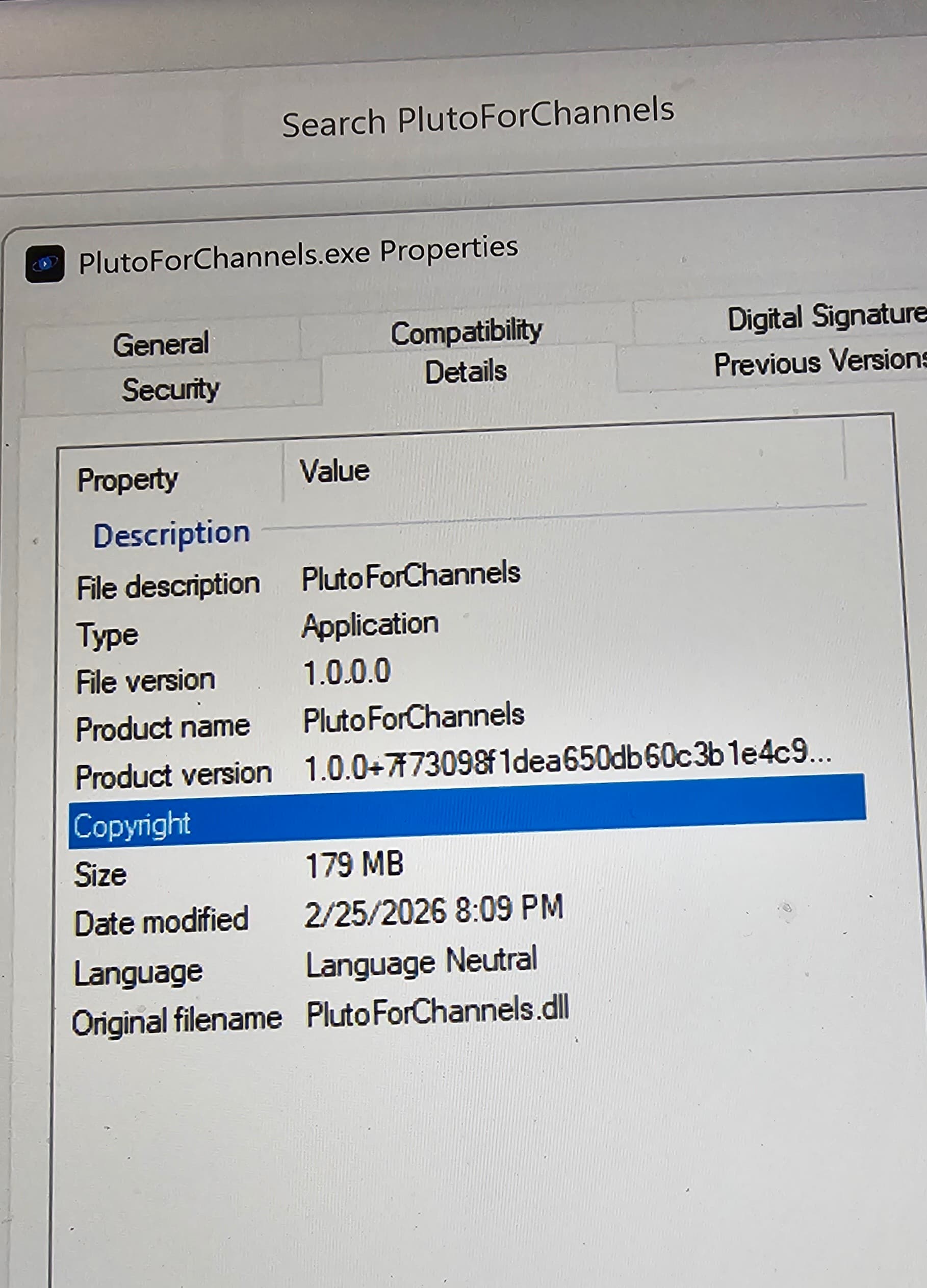

Which version is that?
I don't think you had implemented the version numbers in the dashboard yet with this version, but it was the last version before you implemented the multiple streams at once capability. It had a date stamp of 2/25 I believe. Not at home right now so can't do any further checking.
Thank you. I will look into the multi stream changes.
One last piece of info for the version that works fine. There is only the option for one login, not the 4 you had implemented right after that.
