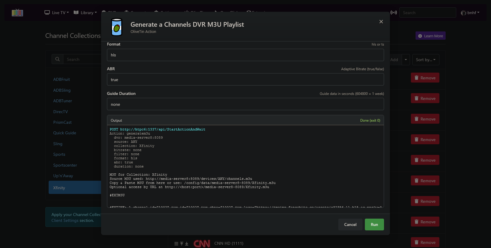

so unsure of the issue here - i do have a channels collection called Channels
Matching the capitalization may matter here, so check that.
Otherwise I just tried this with a Channel collection I have called Xfinity, and although it did output the M3U data, there was some debug data included that shouldn't have been. I'm pushing an update now.
Here's what you should be seeing when generating an M3U for a valid collection:
POST http://htpc6:1337/api/StartActionAndWait
Action: generatem3u
  dvr: media-server8:8089
  source: ANY
  collection: Xfinity
  bitrate: none
  filter: none
  format: hls
  abr: true
  duration: none
M3U for Collection: Xfinity
Source M3U used: http://media-server8:8089/devices/ANY/channels.m3u
Copy & Paste M3U from here or use: /config/data/media-server8-8089/Xfinity.m3u
Optional access by URL at http://<host:port>/media-server8-8089/Xfinity.m3u

I've been running into an issue with webui+ ever since I rebuilt my minipc now named NanoA1.
my olivetin env is set correctly
TAG=latest
DOMAIN=
HOST_PORT=1337
CHANNELS_DVR_HOST=10.0.0.7
CHANNELS_DVR_PORT=8089
but any olivetin action is still populating minipc:port
some actions will work when I correct the field to ip, but the post action still uses minipc:1337 so I get a network errror
POST http://minipc:1337/api/StartActionAndWait
Action: adbtuner
  dvr: 10.0.0.7:8089
  TAG: stable
  DOMAIN: localdomain
  HOST_PORT: 5592
  STREAM_TIMEOUT: 8
  HOST_VOLUME: adbtuner_config
ERROR: Error: Network error
everything works fine if I use the olivetin page directly
after drafting this post I gave it the ol college try again, and realized it was a tampermonkey issue.
I had to remove the scripts and re-install them. works as expected now :+1:
