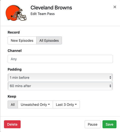

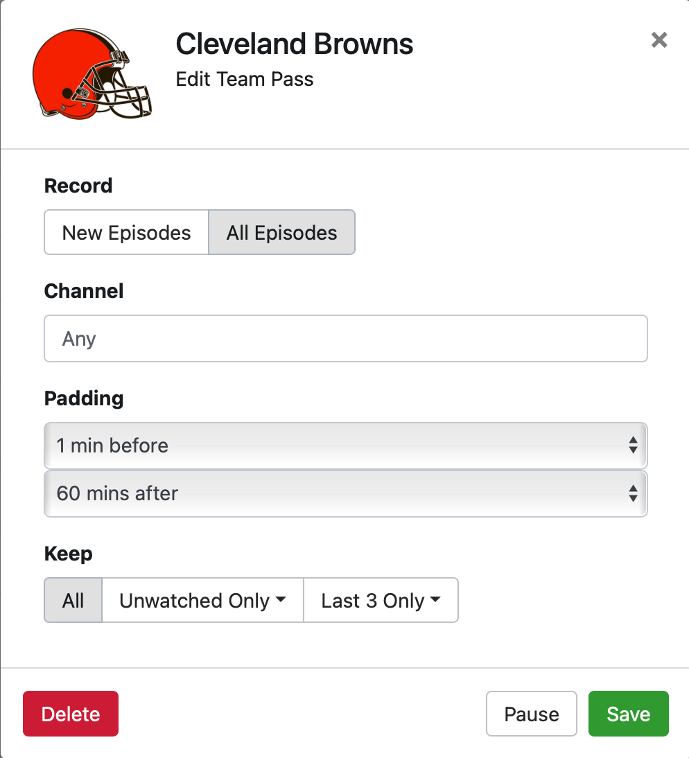

I suppose another way of doing it would be to create a Series Pass specified to a particular channel. Then clone that rule, and modify it to point to the other channel. Since Channels will only record one copy of the episode, it will record whichever channel airs the next episode first.
@tmm1 Is that what I need to do regarding this? My CBS is ATSC 3.0 and currently doesn't work. I am lucky enough to have a secondary market for CBS, FOX and ABC. Because with football, this could be CBS, NBC, FOX and ESPN? My main concern is CBS at the moment.
