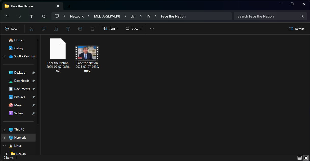

This will vary a bit by how you set things up, but for example yesterday's Face the Nation:
Plus, as the log shows, Comskip was run and there should have been 22 markers written to a matching EDL file. Here's mine from the above recording:

Thanks again, I don't have the EDL file in my directory:

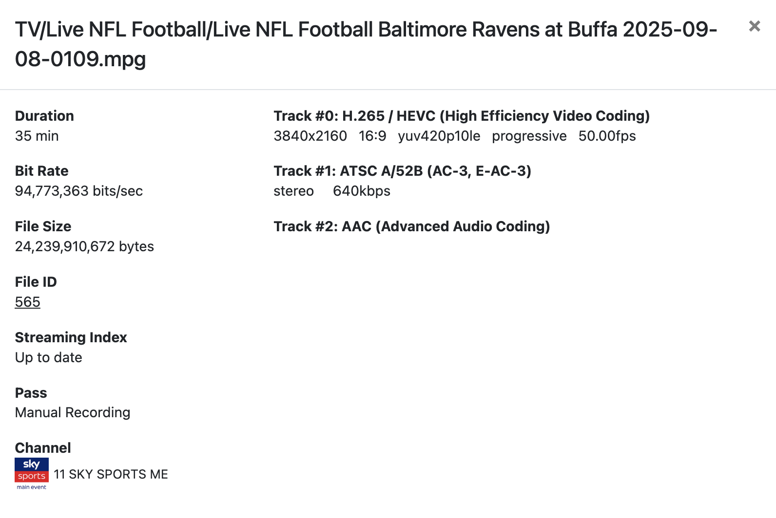

Thanks @tmm1 this is the View Details screen:
Try Fix Timestamps
Right you are, I forgot EDL file generation required a tick box selection in settings. Comskip appears to have had problems with the file too, based on time running and the markers it generated.
At 24GB for an H.265 recording, it would seem to be all there, so hopefully @tmm1's Fix Timestamps suggestion will take care of it.
Thanks a lot that actually sort of worked. I now have the full video file that is 4 hours and 5 mins which is great except that the file doesn't seem to have any sound. There was audio in the intitial 34 minute file but now there doesn't seem to be any audio at all.
Any idea what might be causing this or how I can further debug it?

Does View Details now show any audio tracks?
I would have remuxed it with ffmpeg instead of using fix timestamps.
When you run fix timestamps, it overwrites your original recording.
Before running fix timestamps, you should make a copy of the recording in case it makes it worse (based on experience).
Thanks. Can you explain what the point about MPEG-TS and HLS means? Is there something I need to change because of this?
Also view details does show an audio track:
Track #1: ATSC A/52B (AC-3, E-AC-3)
stereo 640kbps
I'll try and figure out how I can remux it with ffmpeg and see if that helps.
