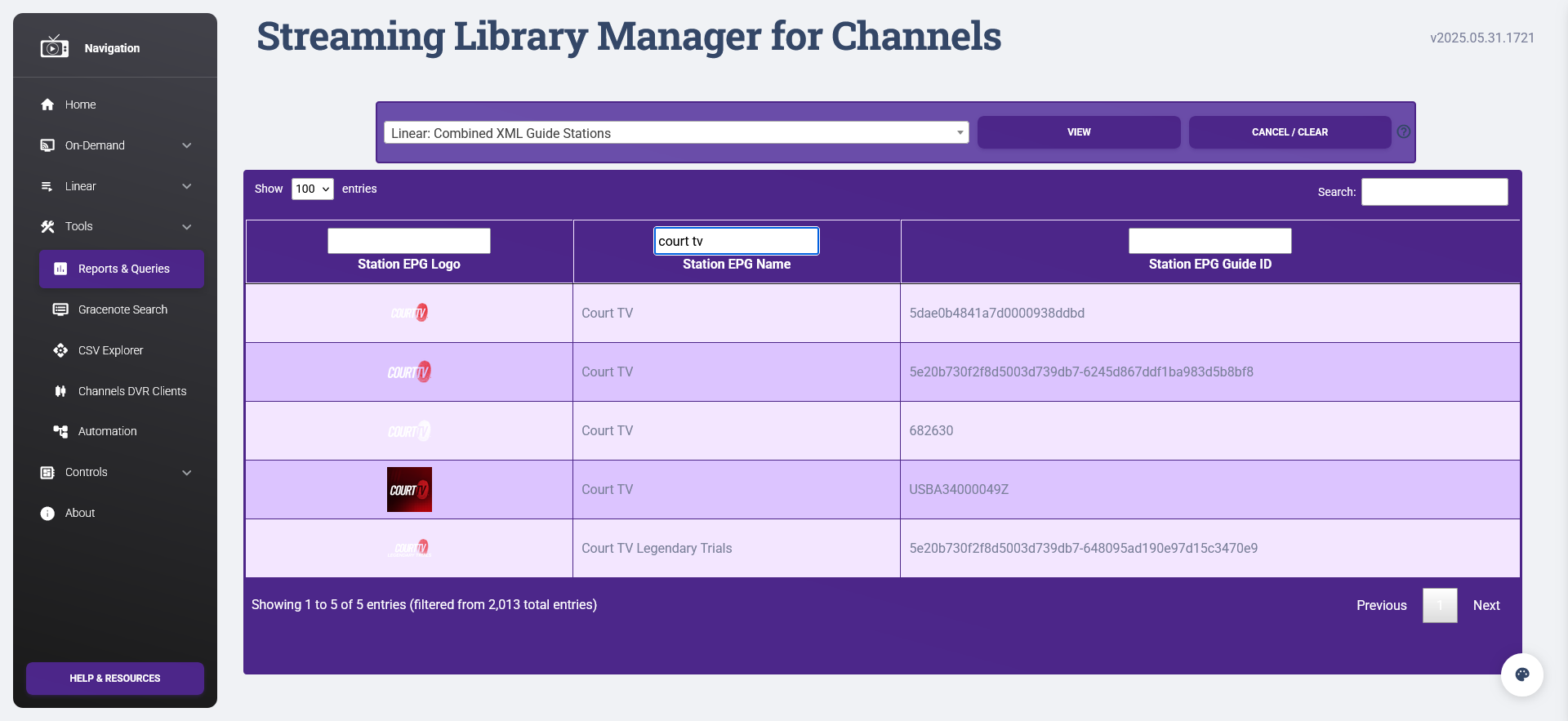

Well, the XML guide data doesn't really exist inside of PLM that it can be pulled up on the fly; they are always just called dynamically when needed. However, I can create a report that does this functionality:
This will be made available in the next release!

Getting this error when testing this report:
Internal Server Error
The server encountered an internal error and was unable to complete your request. Either the server is overloaded or there is an error in the application.
I'll need logs from when you run it, please.

Can you confirm for me that you have a situation like this in at least one of you XML guides:
<display-name>
   Blah Blah
</display-name>
As opposed to:
<display-name>Blah Blah</display-name>
And if there are any other oddities, like spaces around the display-name field?
here's some samples from my sources:
Try this version:
If you are still getting errors, there should be more info in the logs now.
