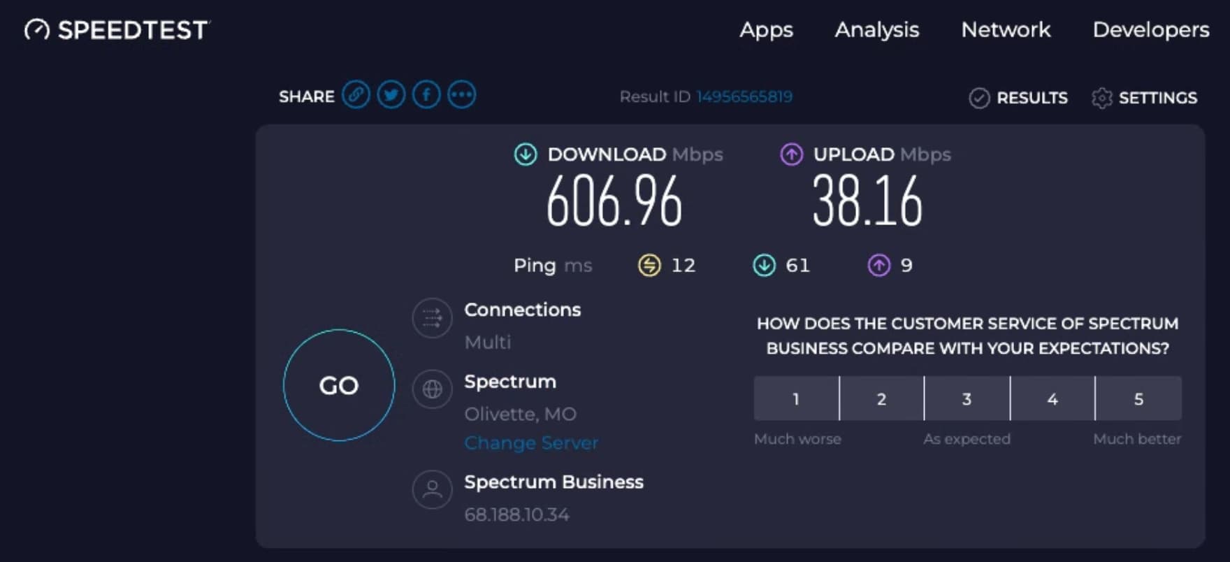

I'm no expert on this, but I believe that 170 number is your download latency. When I was reading up on good speed, latency, jitter, etc., I believe I saw somewhere that latency above 100 could cause problems.
No, 26ms is his latency. 170ms is the latency while downloading, perfectly normal.
This speed test does not show 600/40

The point here is that there is MORE than enough bandwidth and MORE than enough server horsepower that I should not be having any remote streaming issues whatsoever. I simply don't understand why Channels is having such a hard time performing this properly. The Ubuntu server is updated to the very latest software updates. What else could it be???

Support has stopped responding to me since I provided speed tests confirming the speeds were more than sufficient. I sent logs from the Channels iOS client and they said they were seeing 2.9kbps coming from the server to the iPhone.

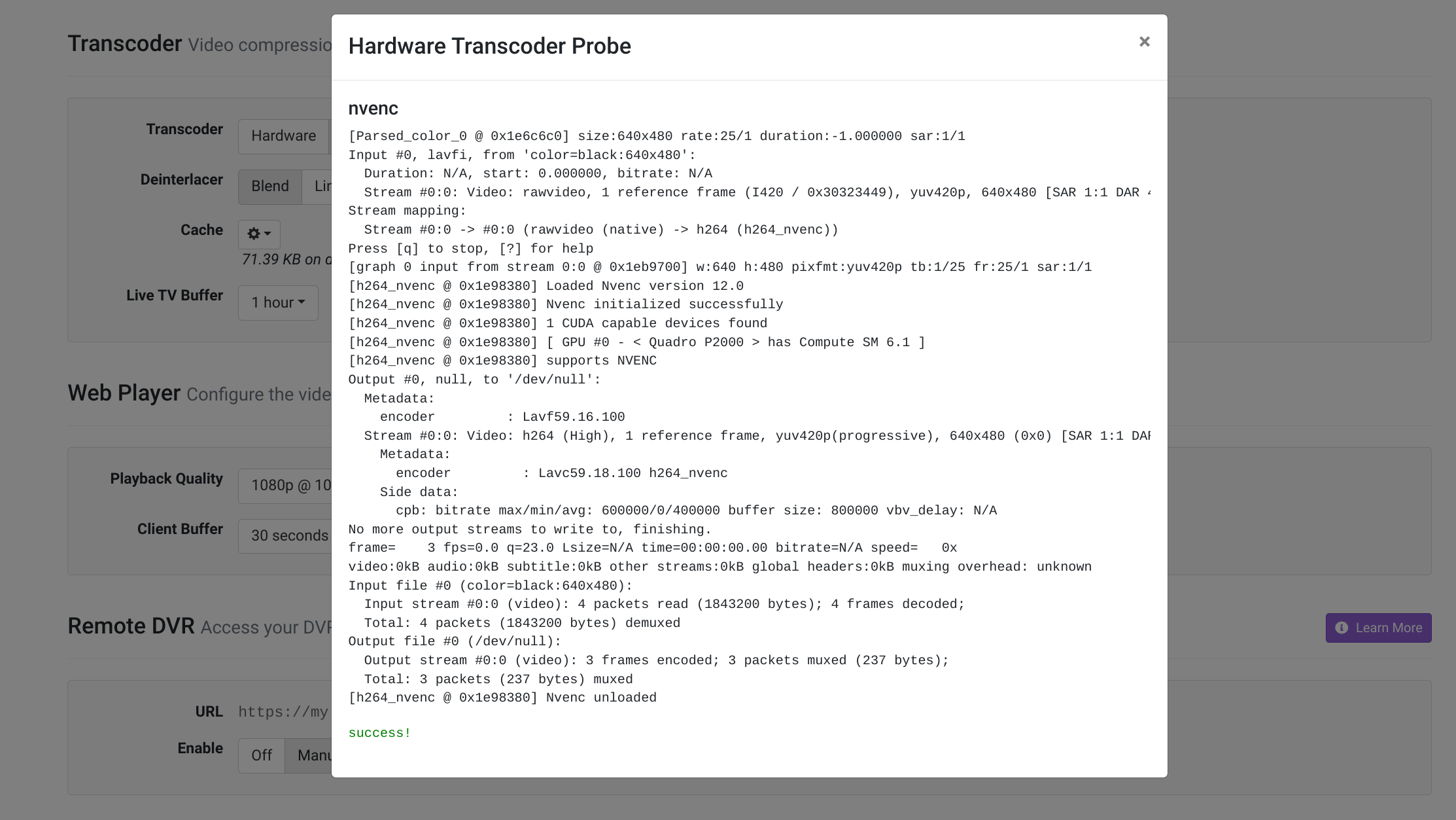

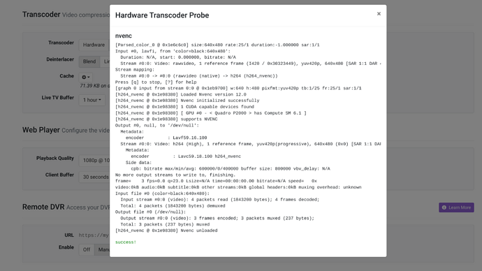

It looks like we're having problems with your hardware encoder:
2023/07/05 17:26:30.024096 [HLS] ffmpeg: file1134-6f1688fc1486:  [h264_nvenc @ 0x2b45680] OpenEncodeSessionEx failed: unsupported device (2): (no details)
2023/07/05 17:26:30.060477 [HLS] ffmpeg: file1134-6f1688fc1486:  [h264_nvenc @ 0x2b45680] No capable devices found
2023/07/05 17:26:30.060571 [HLS] ffmpeg: file1134-6f1688fc1486:  Error initializing output stream 0:0 -- Error while opening encoder for output stream #0:0 - maybe incorrect parameters such as bit_rate, rate, width or height
2023/07/05 17:26:30.062337 [HLS] ffmpeg: file1134-6f1688fc1486:  [aac @ 0x2aacc40] 2 frames left in the queue on closing
2023/07/05 17:26:30.062361 [HLS] ffmpeg: file1134-6f1688fc1486:  [aac @ 0x2b3a0c0] 2 frames left in the queue on closing
Changing the encoder to Software will help your situation, but the logs don't show any details why the hardware encoder is not working.

I know, but I have an nVidia card installed with their Linux drivers.
You have decent upload bandwidth. Why not just use original quality and forget about transcoding?
So how do we fix the hardware encoder issue? How can I get you more detail for further troubleshooting?
Channels Dev/Support: Bump. What are next steps?
Does it work with software transcoding? Does it work without transcoding?
Are your nvidia drivers up to date?
