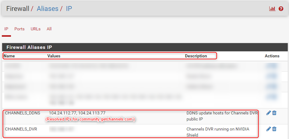

In order to remedy this I setup some packet captures and found out that the Remote DVR DDNS IP update function essentially talks to one of two CloudFlare IPs used by FancyBits, presently 104.24.112.77 and 104.24.113.77. With this information I was able to create an alias for those IPs and a policy based route on my router's firewall (I use PFSense) which forces any IP updates from the Remote DVR out of the VPN while letting all other TVE stream targets download using my local cellular gateway (and thus not eating into my VPS transfer limits). The rule looks like this for anyone who cares:
Rule Action: Pass/Allow
Source Protocol: IPv4
Source Network: LAN
Source Host: [Channels DVR IP]
Destination: [104.24.11x.77 IPs Alias]
Gateway: [VPN Interface GW]
Obviously if you use IPv6 in your setup you would need to add aliases/rules for those addresses too but I only use IPv4 on my LAN at the moment so I didn't mess with that.

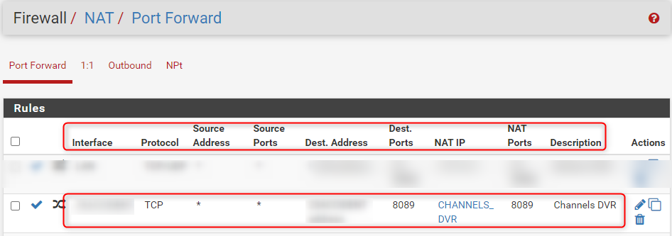

  2. PORT FORWARDING. I assume that 8089 port forwarding that is specified on my router rules for my Mac mini client IP will work once I get the VPN public IP endpoint specified on my access point.

For your "IP ENDPOINT FIX" query, basically the setup boils down to split tunnel routing on the router side so that the appropriate gateway is used on egress. I use pfSense and accomplish this with policy based routes in the firewall but this can be done in OpenWRT firewall (iptables) as well. You are in luck that there are trailblazers ahead of you that have created OpenWRT packages to help with this, see here:
At a high level you would create rules yourself, or with the help of the packages above, which would direct devices in your AP's subnet (or specific device IPs if you wanted to be more granular) to use the VPN connection as their gateway instead of your AT&T connection. In pfSense my firewall rule looks like this, but will obviously look different in OpenWRT (I use aliases for easier reading of my firewall rules which is also defined below):
For your "PORT FORWARDING" query, yes you would forward 8089 coming in from your VPN to your Channels server local IP. In pfSense my forwarding rule looks like this, but will obviously look different in OpenWRT:
As was already mentioned rightfully by @tmm1 in his earlier reply, using the hostname instead of specific CloudFlare IPs will be more robust in case more IPs are added/changed in CloudFlare for 'community.getchannels.com' (I'm simply lazy and haven't gone back to update my rules to route by hostname).
