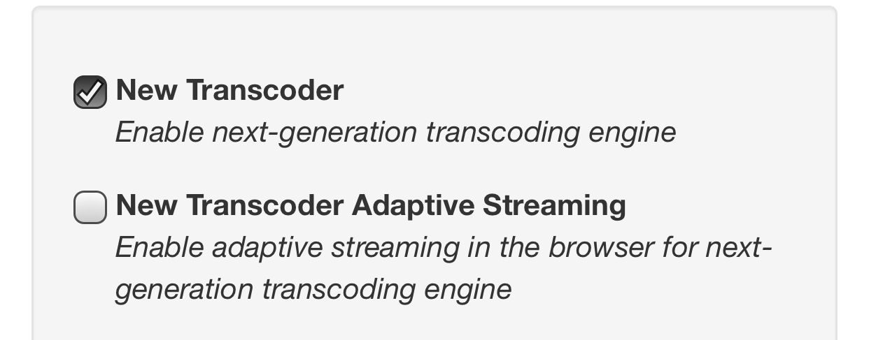

Testing the new Experimental Transcoder (for improved remote viewing of recorded content)
Is ok to select both settings?
Yes. More details about it are here:
