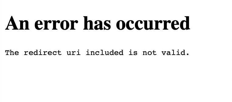

But when I click the button to "Set Up New DVR" and proceed to login, I only reach a white screen with an error "The redirect uri included is not valid."
Screenshot below:
It seems to be taking me to this URL (replaced IP for security)
https://community.getchannels.com/oauth/authorize?access_type=offline&client_id=5a1ee61b287980862dce7863438b1e1e22186342f6fc1f95c1e8daa8cec8d5f9&redirect_uri=http%3A%2F%2FIP.IP.IP.IP%3A8089%2Fauth%2Fconfirm&response_type=code
Is there anything I can get this running / authenticated to login?
Many thanks
osk3

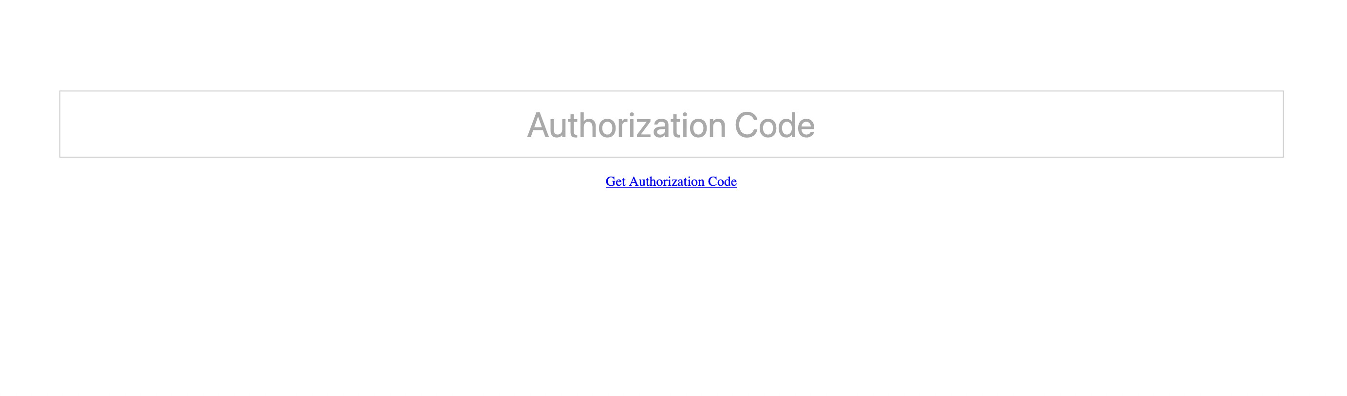

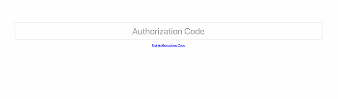

Also tried restoring from backup but now get this screen.. any help appreciated
EDIT:
OK THINK I GOT IT!
