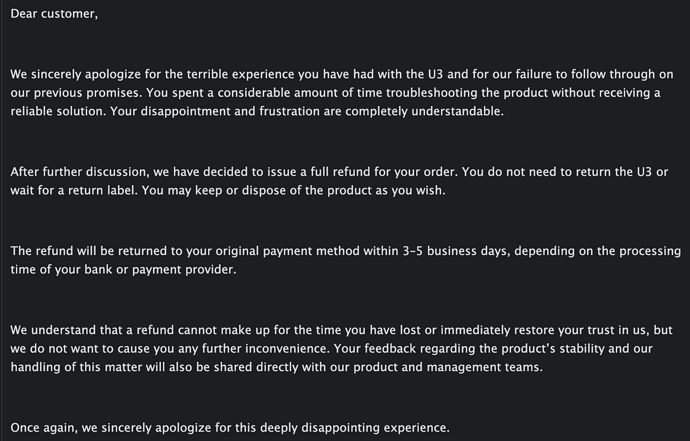

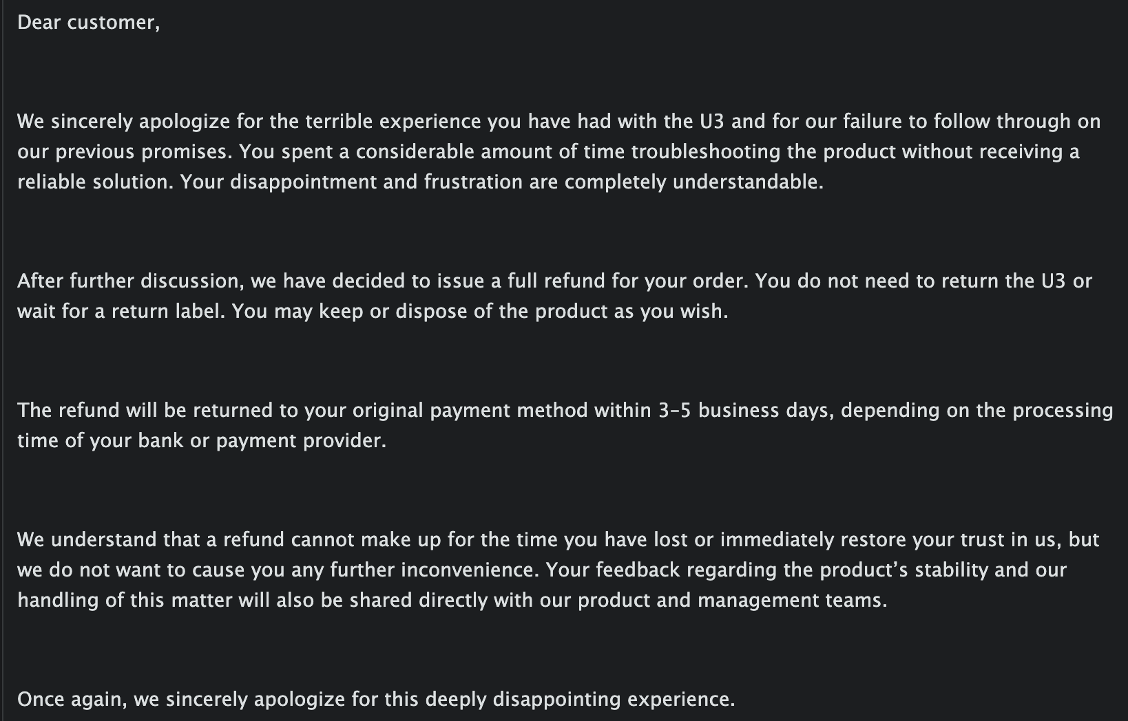

I think that worked. Out of nowhere, I got a full r e f u n d for my order, but no return label or anything. I guess they kind of acknowledged that they botched this launch. Also, they would probably rather me not initiate a chargeback, so much safer to just r e f u n d and have a happy repeat customer than someone that is going to go on social media and complain like I threatened to.
When I say this is like the worst piece of electronics I have ever purchased, this is the worst electronic device I have ever purchased. It is really just horrific. I am hoping it gets better with firmware updates, but right now it is bad.
Edit:
They sent me this last night. At least they're trying to do the right thing given they sent me a completely broken remote from a software perspective.
