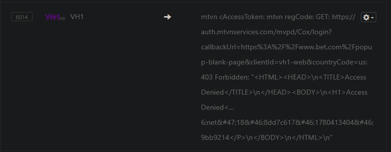

VH1 and BET not working with TVE
Both have auth failures, any fix or will they be removed?
Logs submitted

No go for me with VH1 using both YTTV and Philo credentials.
2026/04/09 10:50:40.386416 [ERR] Failed to start stream for ch6014: TVE: mtvn cAccessToken: mtvn regCode: GET: https://auth.mtvnservices.com/mvpd/YouTubeTV/login?callbackUrl=https%3A%2F%2Fwww.bet.com%2Fpopup-blank-page&clientId=vh1-web&countryCode=us: 403 Forbidden: "<HTML><HEAD>\n<TITLE>Access Denied</TITLE>\n</HEAD><BODY>\n<H1>Access Denied<…;net&#47;18&#46;a60c2e17&#46;1775731840&#46;c1767c89</P>\n</BODY>\n</HTML>\n"
2026/04/09 10:50:40.390630 [HLS] Couldn't generate stream playlist for ch6014-dANY-ip192.168.0.121: TVE: mtvn cAccessToken: mtvn regCode: GET: https://auth.mtvnservices.com/mvpd/YouTubeTV/login?callbackUrl=https%3A%2F%2Fwww.bet.com%2Fpopup-blank-page&clientId=vh1-web&countryCode=us: 403 Forbidden: "<HTML><HEAD>\n<TITLE>Access Denied</TITLE>\n</HEAD><BODY>\n<H1>Access Denied<…;net&#47;18&#46;a60c2e17&#46;1775731840&#46;c1767c89</P>\n</BODY>\n</HTML>\n"
2026/04/09 10:50:40.390657 [HLS] Stopping transcoder session ch6014-dANY-ip192.168.0.121 (out=0s finished=false first_seq=0 last_seq=-1)

Hi, Haven't seen a resolution to this issue in this thread. Someone said send logs so I did.
Same issue, Windows, channels version 2026.04.12.0247. Sent New diagnostic log submitted under f728ef9e-bf82-499b-8647-896043a40ae1. Can watch live on VH1 or BET websites.
Full error is - Could not start stream for TVE-Spectrum ch6014 VH1: TVE: mtvn cAccessToken: mtvn regCode: GET: https://auth.mtvnservices.com/mvpd/Spectrum/login?callbackUrl=https%3A%2F%2Fwww.bet.com%2Fpopup-blank-page&clientId=vh1-web&countryCode=us: 403 Forbidden: "\nAccess Denied\n\n
Access Denied<…;net/18.a07c4217.1776145401.227d48c2
\n\n\n"

Seven weeks ago I was getting this error
they still aren't working, getting 403 Forbidden: Access Denied on both channels.

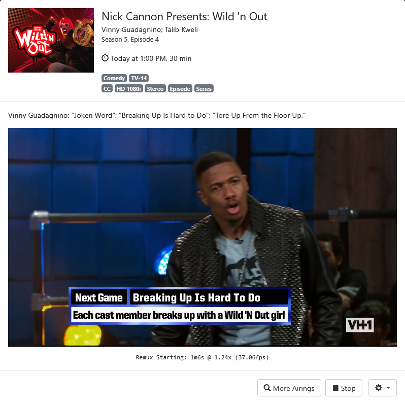

Don't know when they were fixed, but both channels are working for me now with v2026.05.26.1844
Not for me!
2026/06/02 11:16:43.967088 [TVE] Channel scan VH1 failed: mtvn cAccessToken: mtvn regCode: GET: https://auth.mtvnservices.com/mvpd/Cox/login?callbackUrl=https%3A%2F%2Fwww.bet.com%2Fpopup-blank-page&clientId=vh1-web&countryCode=us: 403 Forbidden: "<HTML><HEAD>\n<TITLE>Access Denied</TITLE>\n</HEAD><BODY>\n<H1>Access Denied<…6;net&#47;18&#46;8dd7c617&#46;1780413404&#46;9bb9214</P>\n</BODY>\n</HTML>\n"
Both channels are now working for me on v2026.05.26.1844 using the debian YTTV TVE container.
I don't scan individual channels because of those issues.
I had just updated my debian YTTV TVE container
So to test it, I was tuning every TVE channel by watching them in the DVR web UI.
I do that instead of scanning individual channels so I don't lose the channels if they fail.
I'm getting every channel, except for FOX local, HLN, CNNI and WeTV.
Here's the log from when VH1 and BET reauthorized while I was trying to play them in the DVR web UI. Notice it took about a minute for each channel to auth.

And they're both still working.
None of these channels (VH1, VH1P, BET, BETP) are currently working for me on v2026.05.26.1844 using the Ubuntu WSL2 Cox TVE container.
No issues in Web or Android/Roku Apps, so it is not network or machine. It is Channels. Just to be sure, I've been through several cycles of upgrades, reboots, and rebuilds of my provider, all to no avail.
Since I can't get past scanning anymore, I don't have the stations to just try to play. But when I did, it was the same message, as it has been for many weeks.
Just because your situation is better, doesn't mean everyone else's is or an official fix has been released. Therefore, I don't believe this should be marked as resolved.
Fair enough.
I thought maybe they were part of the "various channels" mentioned.
Since I don't see any mention of which ones were fixed.
@JMcGuire
Are the channels working for you, or still broken?
Since at least v2026.07.07.0514, and definitely in v2026.07.18.0414, I am now able to successfully scan and play VH1 and BET again!
