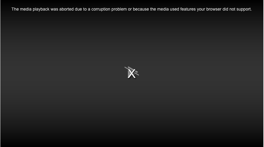

I also can now no longer playback in web due to this issue...
As soon as I play a video, at the bottom it just says transcoder finished and then spins for a while and then errors with what you see there.

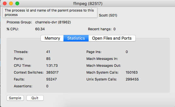

Plex is running right now but CPU usage is as you see here...
