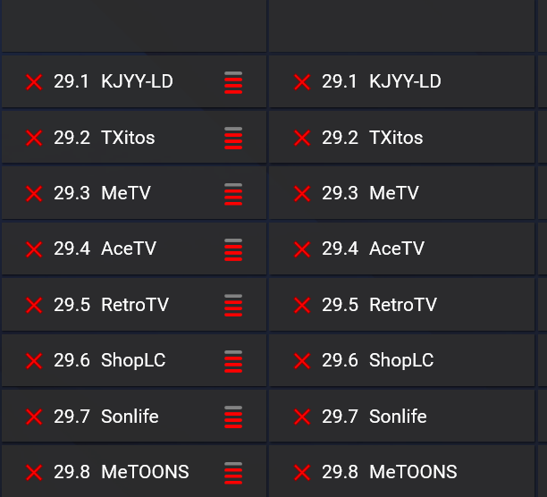

Same problem. It always seems to select the weakest signal. I've had to go through the HDHR and hide all the weak channels. Trouble is, new channels seem to pop up all the time and Channels grabs them and doesn't record because of weak ssignal.
I always favor my best signal Channels. Channels will always prefer favored Channels. I never favor the ATSC 3.0 Channels over the ATSC 1.0. If you bring up the HDHomerun app under settings/channels they have signal strength.
Both of you might want to try marking sources with the best signal as a faverate under sources. Looking at that log, it appears the recording started and then failed. I don't think channels will fail over when this happens. Failover is only if the recording can not start.
I've always done that. Yet when channel 33.1 popped up (which I've never seen before) Channels decided to attempt to recod from that channel instead of KNBC 4.1 which is favored.

I can tell you from personal experience. A few weeks ago I noticed shows on KNBC 4.1 were not being recorded. When I looked at the log there were numerous failures because of no signal levels on channel 33.1 when it should have been using 4.1
4.1 was favored and always has been. 33.1 was not favored since I never saw it before. I deleted 33.1 and edited all my series passes so that they would only record on 4.1. Problem solved.

I have 2 HDHRs. One is connected to a VHF antenna and the other to UHF. The antennas are 20 feet apart. The VHF only has channels 7.1 and 11.1 All others are Xed out.
The UHF HDHR only has 2.1, 4.1. 5.1, 9.1, 13.1 and 28.1 All others are Xed out.
All channels test at 100% signal, symbol, and quality.
