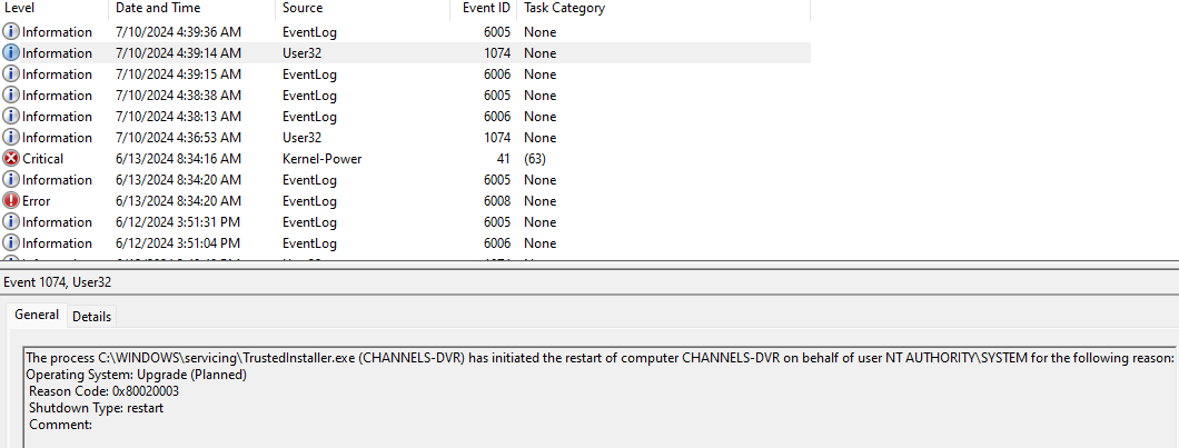

FYI. This issue happened again. I think it's related to installing Windows updates. I remoted into the channels server this morning and it reported it needed to restart due to Windows updates. I rebooted it and everything seemed to come up normally. Later when I checked on the server I noticed none of the lights were on, so I powered it back up. Prior to this it had an uptime of almost a month.
Looking in Event Viewer I saw Incorrect function when Channels started up. I didn't see anything else unusual in Event Viewer.

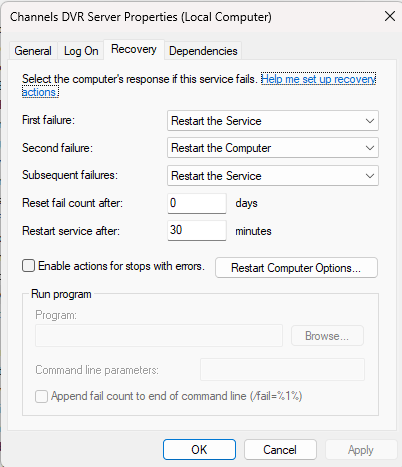

I also have my Windows PC set to not reboot for updates and do that when I remote in, which is what I did the other day. Unfortunately this didn't really shed any more light on my issue. It just showed that my computer rebooted twice for updates. I kicked of the first one at 4:36am. I don't know why it needed a second reboot, but oh well. What's odd is it seemed to come up fine after rebooting, but for some reason shut down a while after. Unfortunately I don't see any logs indicating why. As I'm running this machine headless I can't really tell if it's shut down or in some kind of power save mode (which it shouldn't be as it's set to never shut down.) All I know is I can't connect to it and when I look at the computer, the blue light is off, so I just press the power button. The only time I have this issue is after I've installed updates and rebooted. Once I've started it up after it somehow shut down, it will run 24/7 until the next time I reboot after installing updates.
I see that Critical Power error on your first screenshot can you post the details. It looks like Channels DVR restarted the computer for some reason @tmm1 @eric ... are You running as a service can you look at the properties and see if you have to restart the PC in case Channels DVR Shuts down ?
This is my Service ....
I am running Channels as a service. This is how I have the Recovery tab set. I'll try changing mine to match yours. Unfortunately I won't know if this worked until the next time I reboot to install updates.

The critical power power error indicates the server started without a crash dump or error log entry. Power is assumed yet there are many reasons this can happen.
