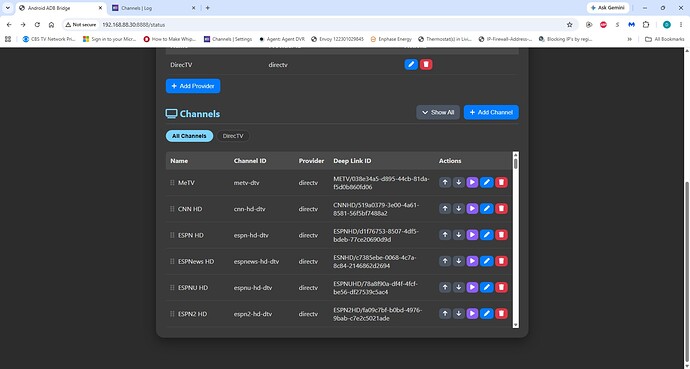

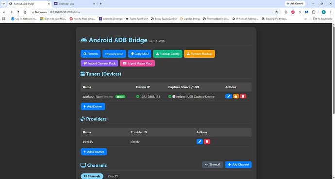

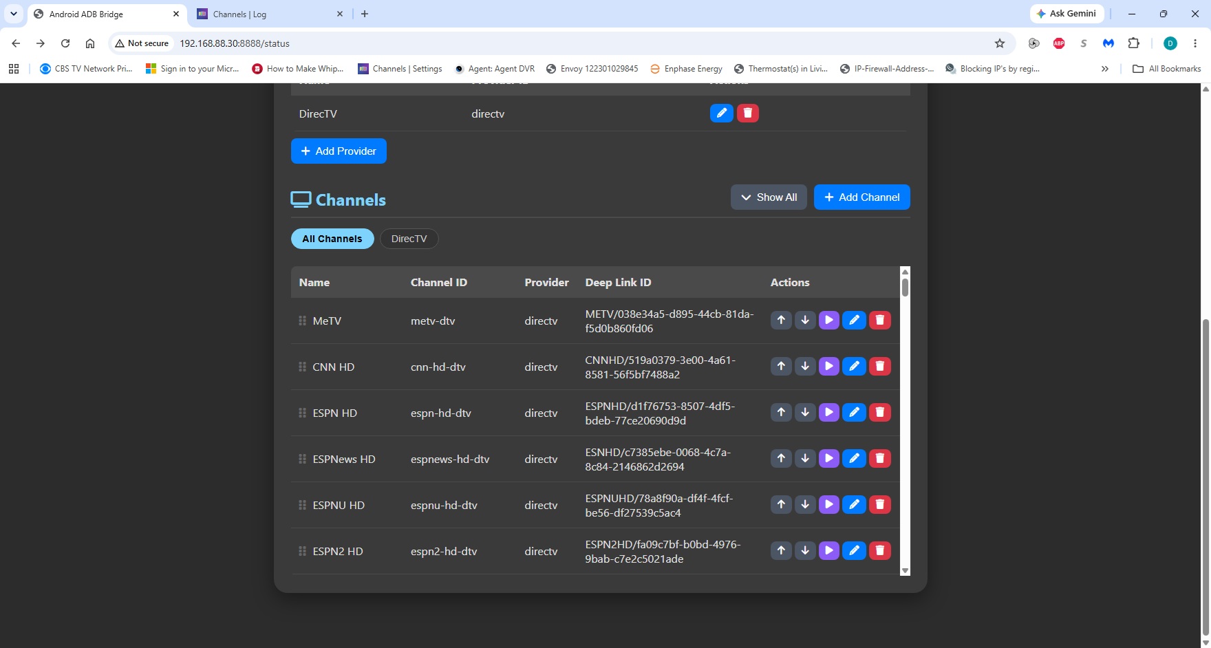

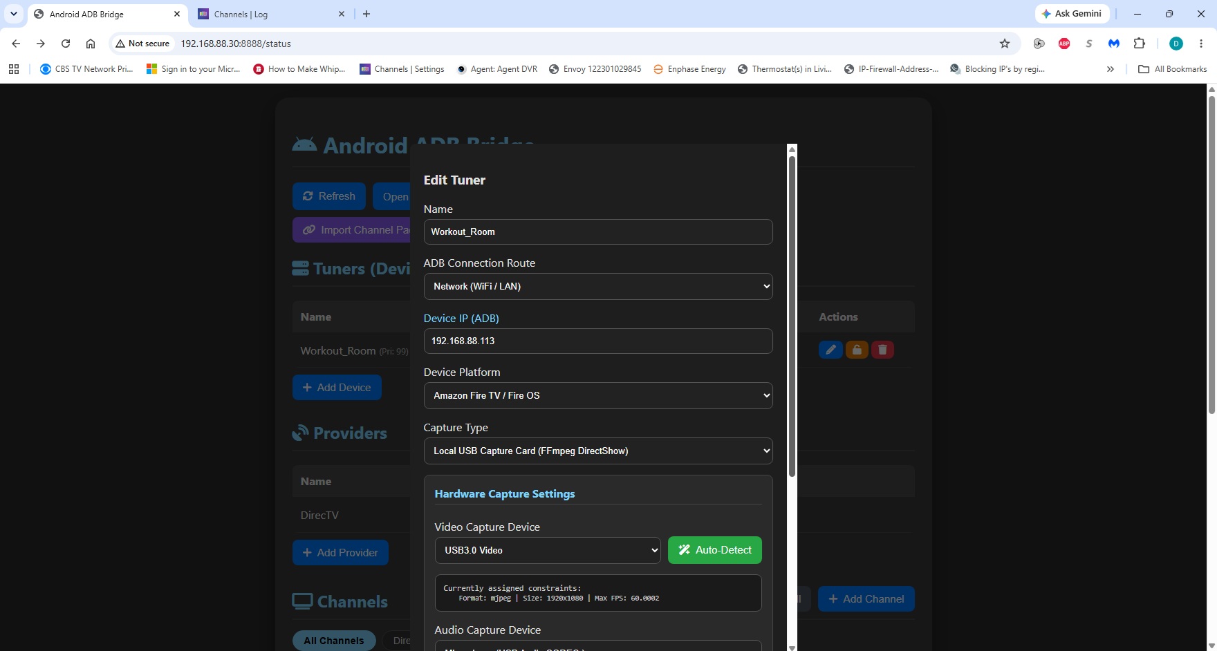

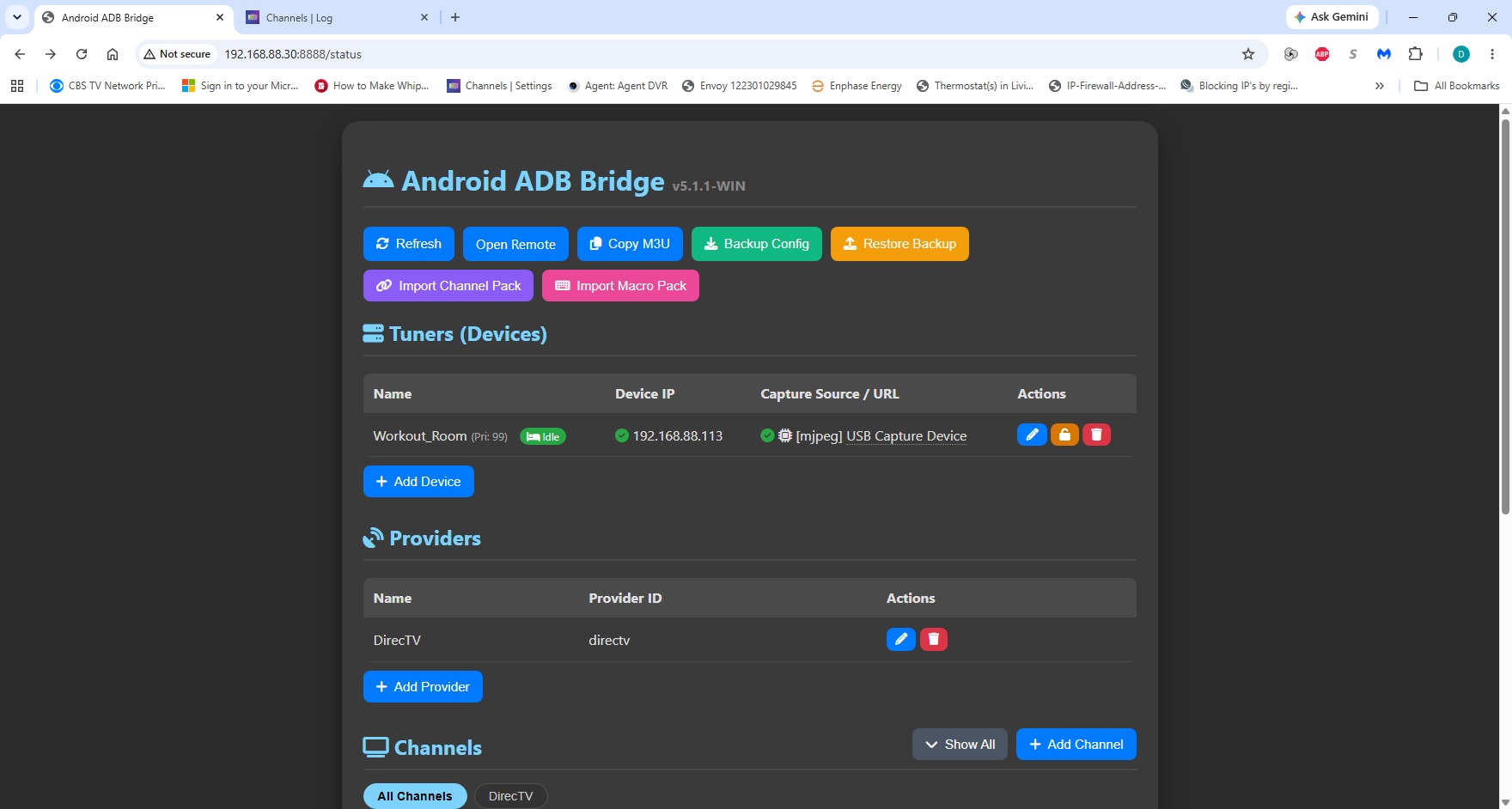

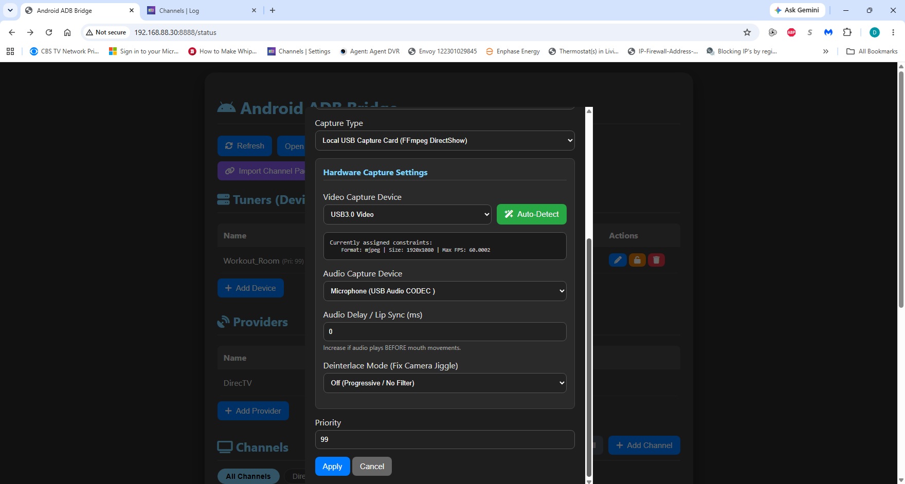

Take a screenshot of you settings in the app and post it here. You may need several screenshots to show it all. Include edit tuner so I can see what you have set up. It could be bad deeplinks from the file I provided. Try other channels too and see if any will work.

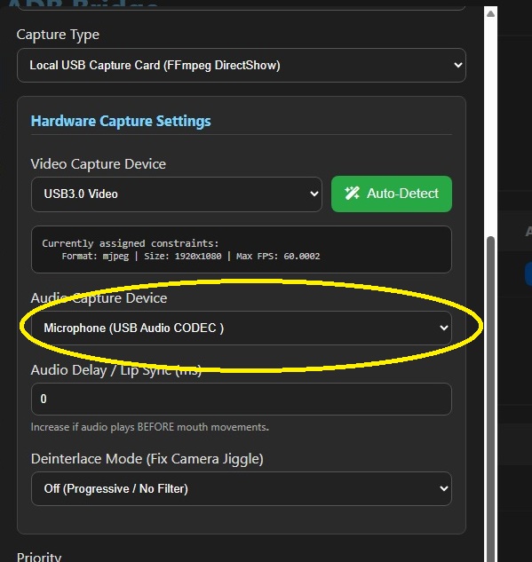

Here you go. BTW, I'm using the Cenmate capture device.
You will need to select the proper audio. It should be something like USB3.0 Audio. That is not what is causing your issues though. I will get a 5 day preview of DirecTV tomorrow and test the deeplinking. Everything else looks fine. I think the issue is my deeplinks that I provided for you.

One more thing to try. On Windows, open Settings/Bluetooth & devices/Cameras. Click on the USB 3.0 Video device and make sure you actually see the Fire Stick homepage on it. If you do, scroll down to Advanced Camera Options and click Edit button and turn on the Allow multiple apps to use the camera at the same time and click Apply. If you do not see the Fire Stick screen, restart the Fire Stick and see if it is picked up.
Well, that's interesting. I don't see anything even after changing that setting and restarting the Fire Stick.
There's our problem. The capture card isn't connected to the PC. Check the USB cable and try changing USB ports to see if it will start to work.
