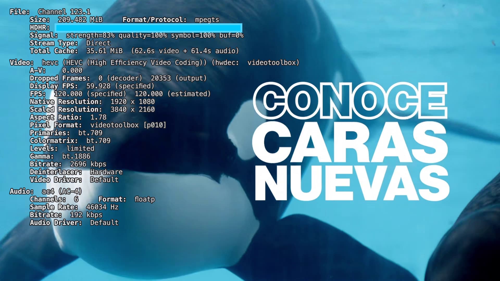

120 fps broadcast spotted
KUVN in DFW
Frame rate : 119.880 (120000/1001) FPS
mediainfo

Nice. 1080p @ 120fps
But it's ATSC 3.0 KUVN Univision
Looking at the counter of dropped frames it increases 60 fps, so only 60 fps are shown, the other half are dropped.
Apple TV can only do 60 fps
Ouch. Can anything handle 120 fps?
