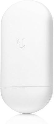

It would be about 400ft and over a road so I was thinking wireless would be the best bet. I was thinking about maybe using something like this:
Think this will keep up with the bitrate I would need?

I don't have direct experience with connecting multiple buildings over wifi, but either of those ideas should work well. You will need an antenna at each building, with a clear line of sight between each.

11Ghz is licensed and would be overkill. Since you are going such short distance the other radios that are I licensed should work fine and a sufficient speed to stream with the home option.
@smswings14 400ft is nothing if you have line of sight, I use NanoBeam AC's but you could get away with the cheaper NanoStation AC Loco.
I agree. I set up my neighbor with the tp-link CPE-510. He is about 1400 feet off the road where the second building is located. We get great speed between the buildings. I think we were getting close to the advertised speed. It's been running for several years now with no problems.
