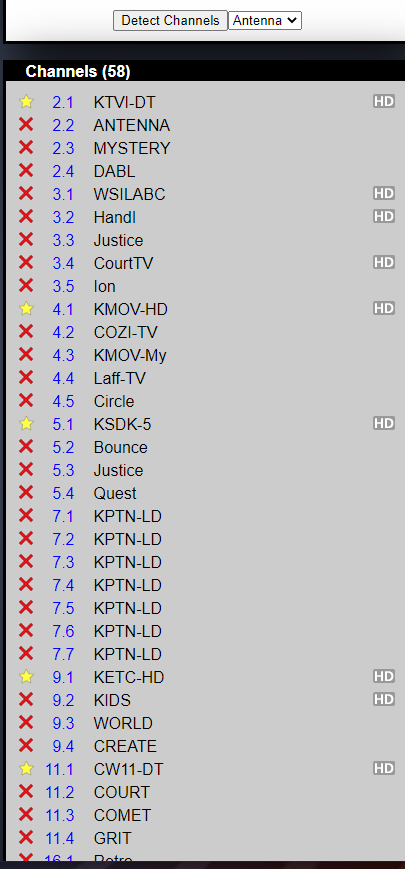

Hidden Channels - There are obviously a lot of channels OTA that are junk or duplicates, and currently duplicate with YTTV and OTA. There are various places to hide channels. I hid them on the DVR interface on the Mac in settings and assumed they'd then not show up on the Apple TV. That didn't work. Is there a place I can turn off channels completely that I don't want so that they don't show up anywhere? Also, if I hide a channel, does that stop it from being used via a Pass?
