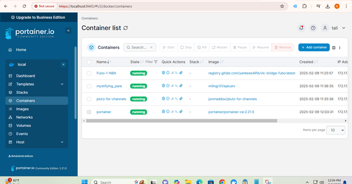

When I install anything on portainer it shows as if it is running but when I go to the url it does not open this is on windows but when I was using ubuntu this wasnt the case, can anyone help me?
Which WSL distro did you install?
How did you install Docker?
How did you install Portainer?
What's a specific example of a container that you can't access?
Why do you keep creating new usernames on this forum?
well I installed wsl by running wsl --install
I installed docker by downloading and installing docker desktop from here https://www.docker.com/products/docker-desktop/
I installed portainer by following these steps Install Portainer CE with Docker on WSL / Docker Desktop | Portainer Documentation
An example of a container that I cant access is the fubo vlc bridge container, when I install it through the cmd I can access it but when I install it through portainer because I have more than one fubo source that I want to use I cannot access it but again it applies for every container that I install in portainer
Im sorry about creating new user names I just really needed the help
When you install multiple versions of the same container there are a number of values you need to change. Are the projects you're trying to spin-up through Portainer deploying without error? Can you post a Portainer screenshot the shows the vlc-bridge-fubo container running?
When I did it on ubuntu with the same values it worked but with windows it doesnt I basically changed everything except the name of the image.
Though the Docker Composes posted here generally don't need to be modified, other than the env vars -- when you want to deploy multiple containers based on the same project you do. In the case of vlc-bridge-fubo, append a "2" to the container name:
For example:

Also, if you could scroll this list of containers over so I can see all the way to the right and post that screenshot.
